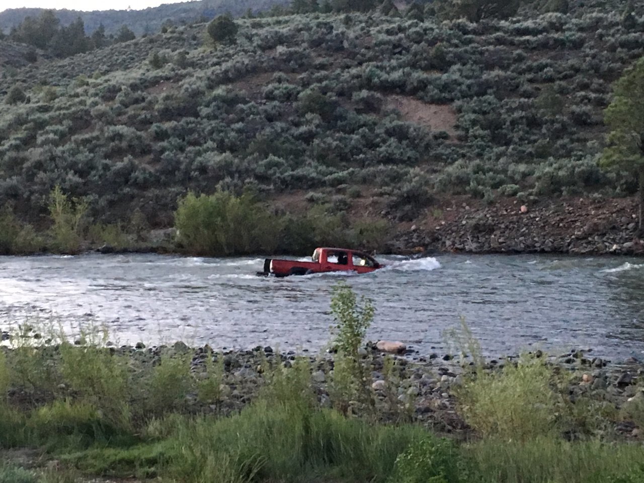

    So, drove my trd into a river where it was submerged to the hood for about 7 hours lol. Pulled it out, pulled spark plugs, intake mani, drained oil (water) and flushed. Cold cranked water out of head. Put back together. Now have a crank no start situation. Getting spark and air, just not fuel. I have power to the fuel pump sender but not the pump. Traced back to relay and don't appear to have power at relay either. Parts replaced: fuel pump, cam position sensors, fuel pump relay and efi relay and fuses. Only thing left I can think of is ecu? Open to ideas and yes critics. Real comments before "part out" comments . Radio works, power windows work, just about everything works but the fuel pump. Thanks in advance.

    ECU wet?

    I mean, ecu was under wanted but pulled connectors and see no signs of water damage or corrosion

    Check the fuel pump resistor in front of the battery
