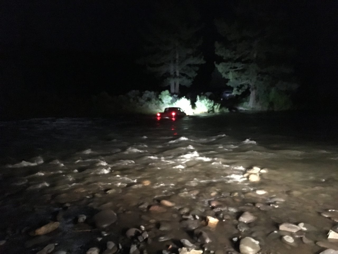

    Maricich_d
    Maricich_d [OP] Active Member
    Jun 12, 2018
    #256277
    39
    07 Tacoma trd
    Almost made it

    Did the motor hydro lock?

    did you check all the relays under the hood? also check every connection under the hood and see if the security anti theft is kicked in. if the cab filled up with water you are going to have to start checking connections and everything under the dash also

    I'm guessing ecu. An ecu could look fine and sometimes even test fine but on certain occasions they could be messed up. It happens on small watercraft like jet ski when theyou have been sunk or something like that

    Should’ve bought a snorkel. And I’m confused on your wording. When you say the engine isn’t cranking, as in you turn the key and nothing happens? Or the engine cranks but doesn’t fire up? If the engine isn’t even turning I would start by checking for power at the starter.

    I’m betting hydrolocked motor. Sorry to hear this OP, looked like a sweet taco.
