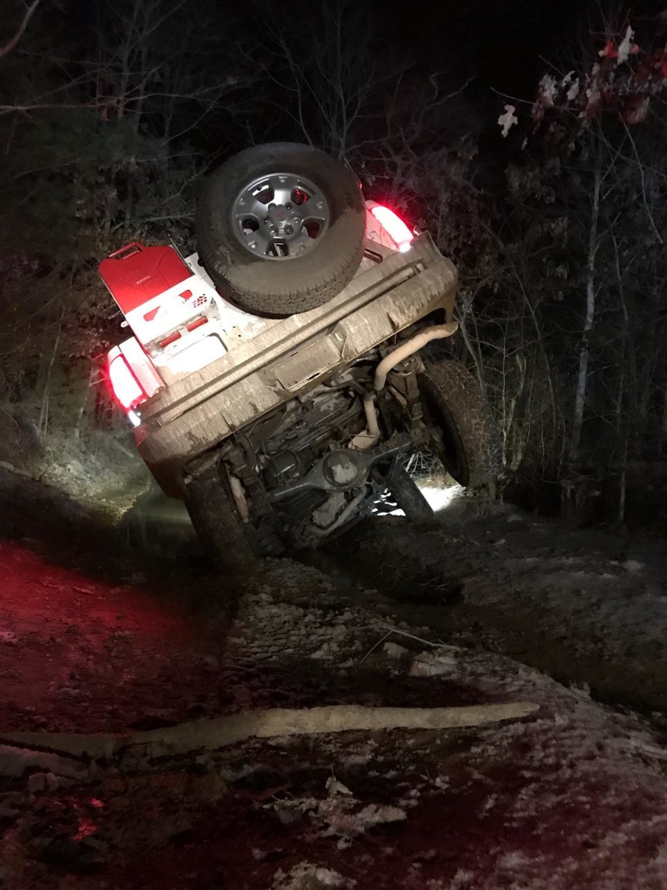

  15. Jun 13, 2018 at 10:38 AM
    #155
    Maricich_d
    Maricich_d [OP] Active Member
    Jun 12, 2018
    #256277
    39
    07 Tacoma trd
    Holy cow! At least we pulled it from the other side so it wouldn't roll. That's the same spot too lol. As a matter of fact, when the sun came up there was another truck that had been pulled out and was sitting right next to that tree lol
