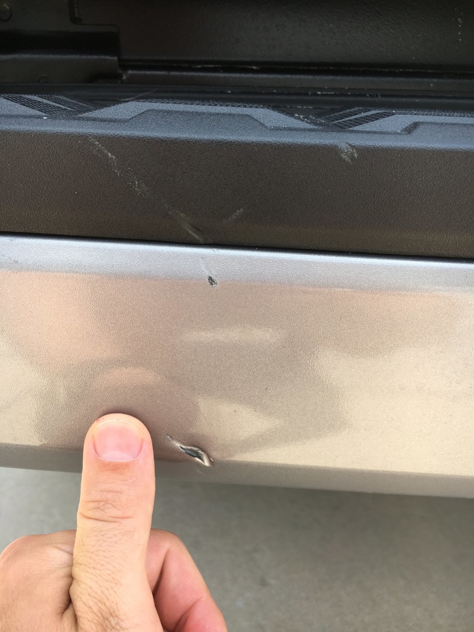

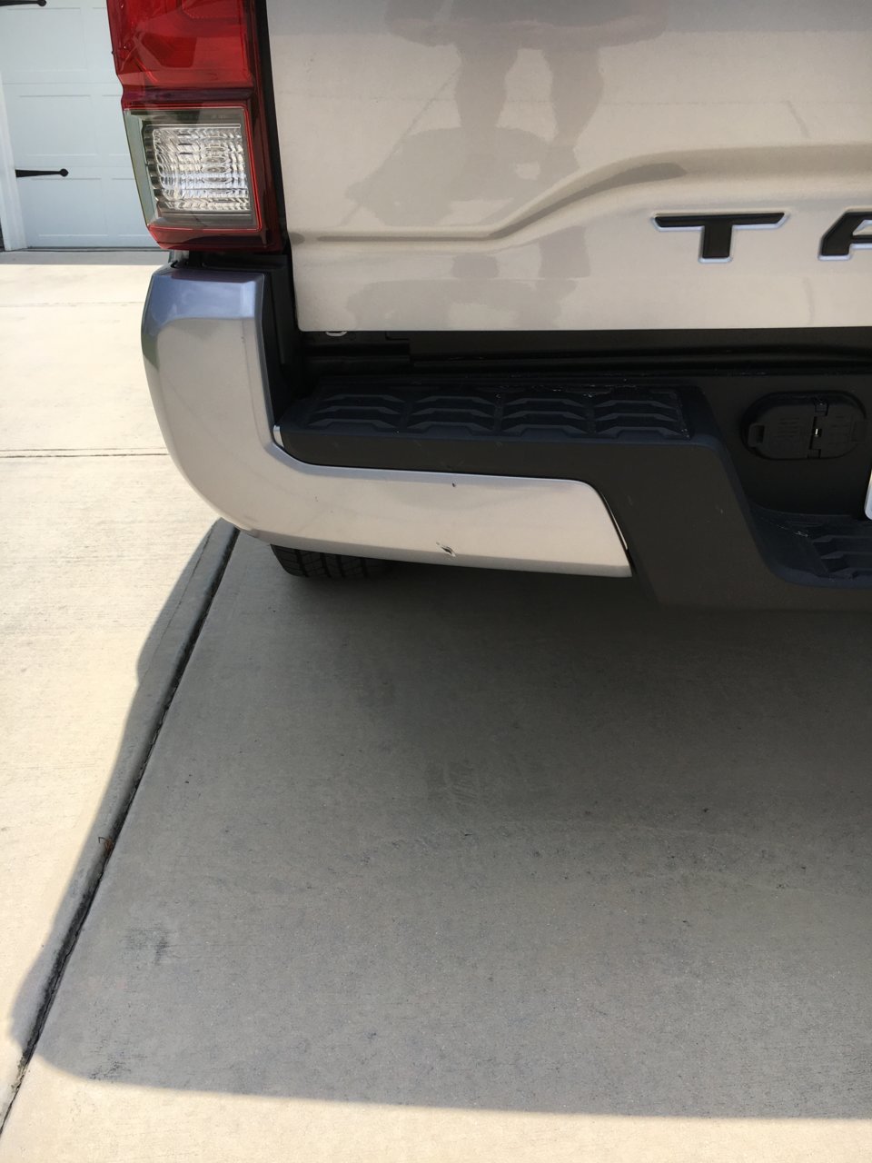

    Wrote in the third gen forum that I got a slight gouge in my rear driver side bumper cap after backing into a chain link... this thread puts things in perspective. It is a good day. Relatively.

    Cant tell if sarcastic. Lol. But yes. Just backing up watching the cam and I think I was waiting for some proximity sensor beeps ( that my wifes Pilot has). No beep so I just kept creeping back. Brain fart.
