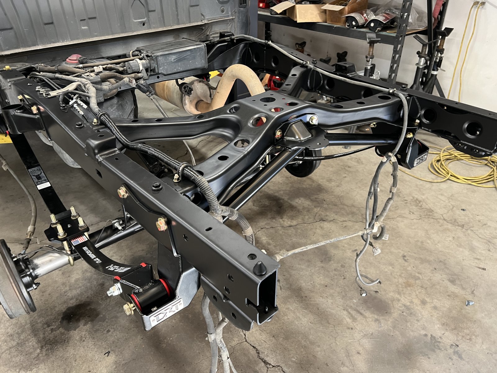

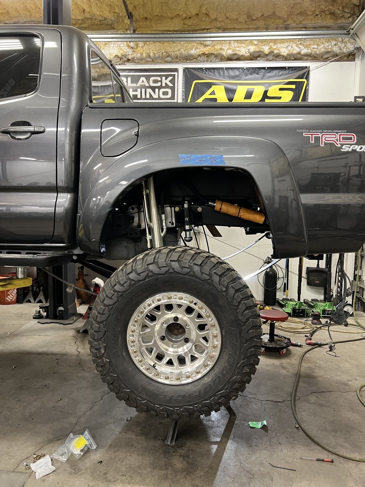

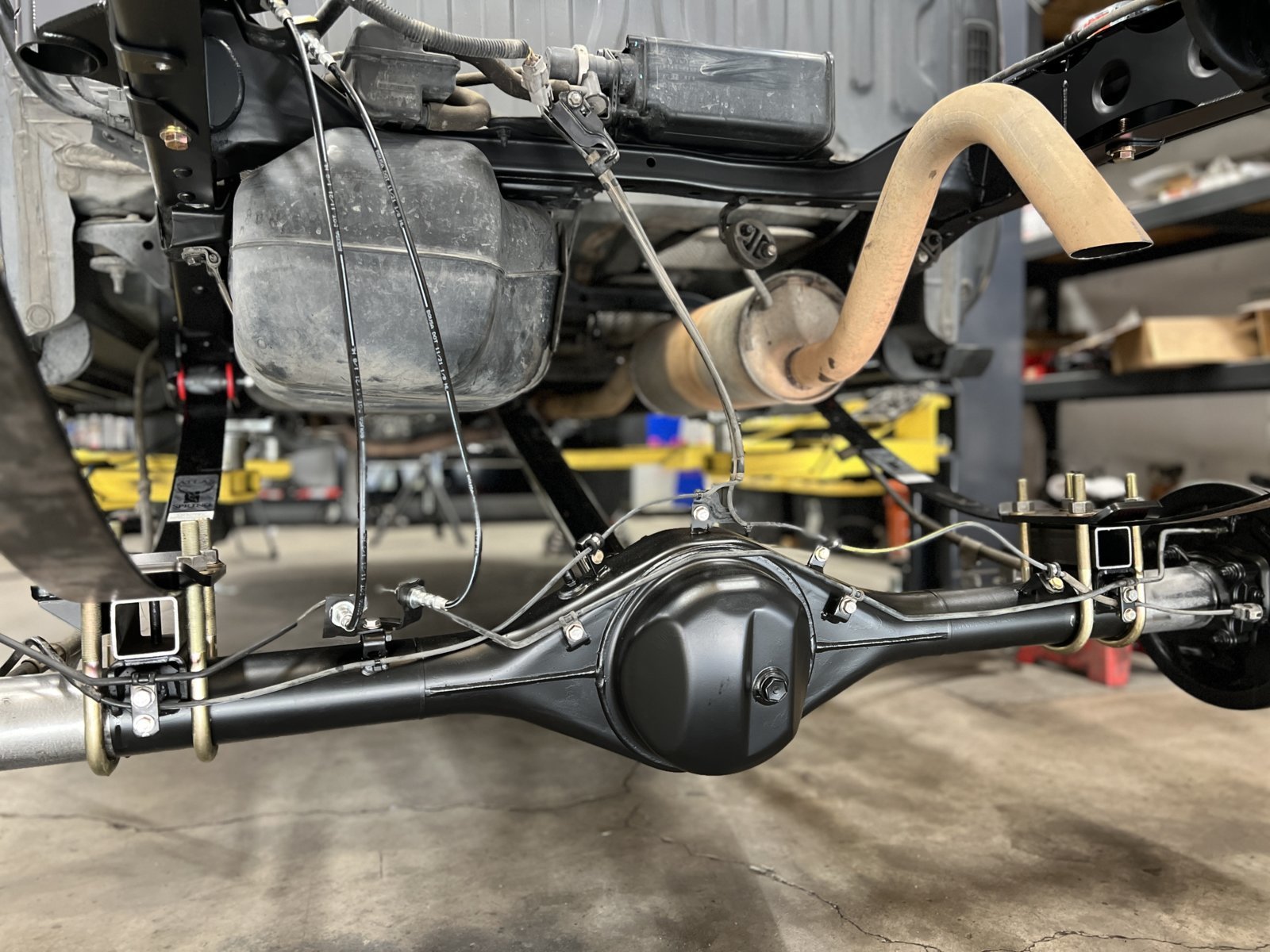

    Good progress on the back half of the Tacoma with @454Motorsports
    Prototype DRT spec @atlassuspension leafs cycled perfectly. 14 5/8” of capable travel and cycled 13 3/8” with the 12” @adsracingshocks bypasses. Some minor tweaks and 16” of travel is a very possible number to hit with a 15” smooth body from @adsracingshock Pretty impressive for a SOA Tacoma AND under the bed. Paired with our shock relocation, hangers, and new threaded bump stops.
    @dmzfab frame boxing kit is in, wiring harnesses are P clamped, axle is nice and refreshed, 24” brake lines are in(will need longer if we push travel numbers past 14 5/8”)
    Final assembly and limit straps going in today along with our CMR on the front.

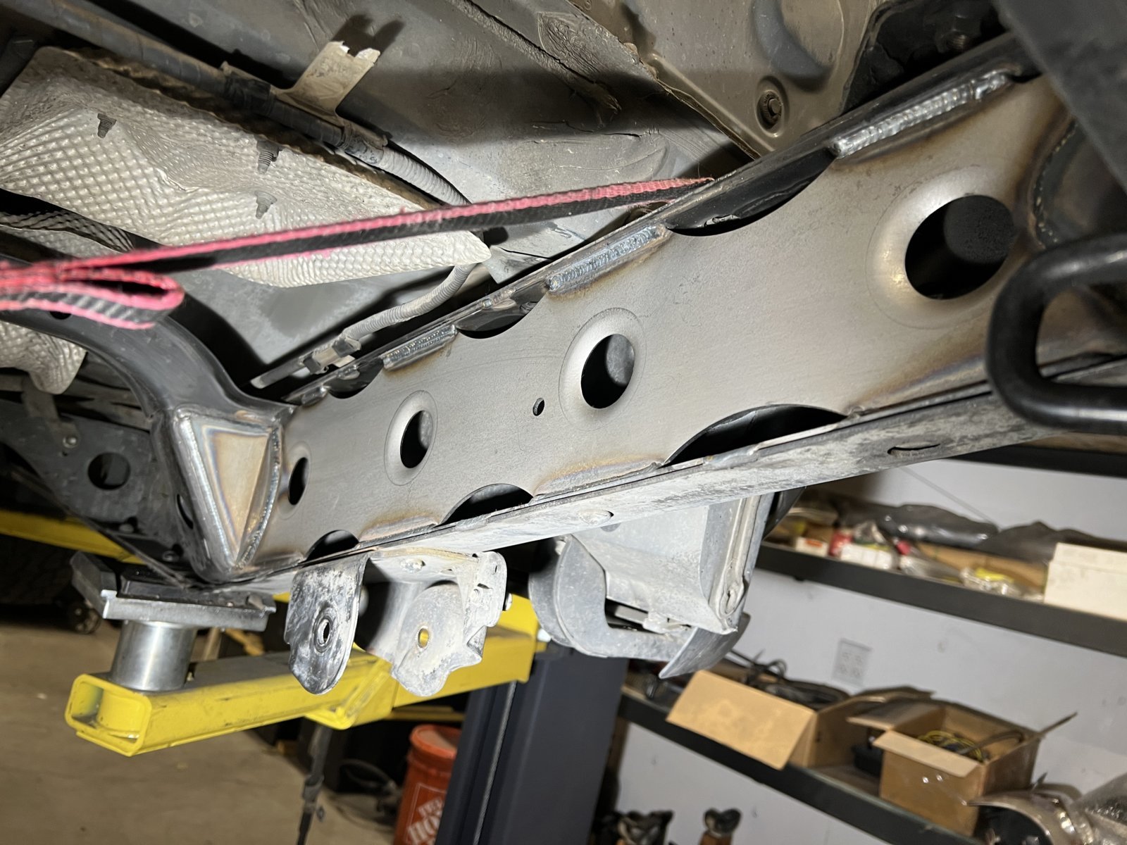

    I finished welding up my drt spindle gussets yesterday. Really nice product from DRT. The fit is perfect.
    Is it a good idea to replace the axle seals in the spindle after welding on them?
    drtfabrication[OP] likes this.

    They can be reused but I typically replace them since I’m already there.

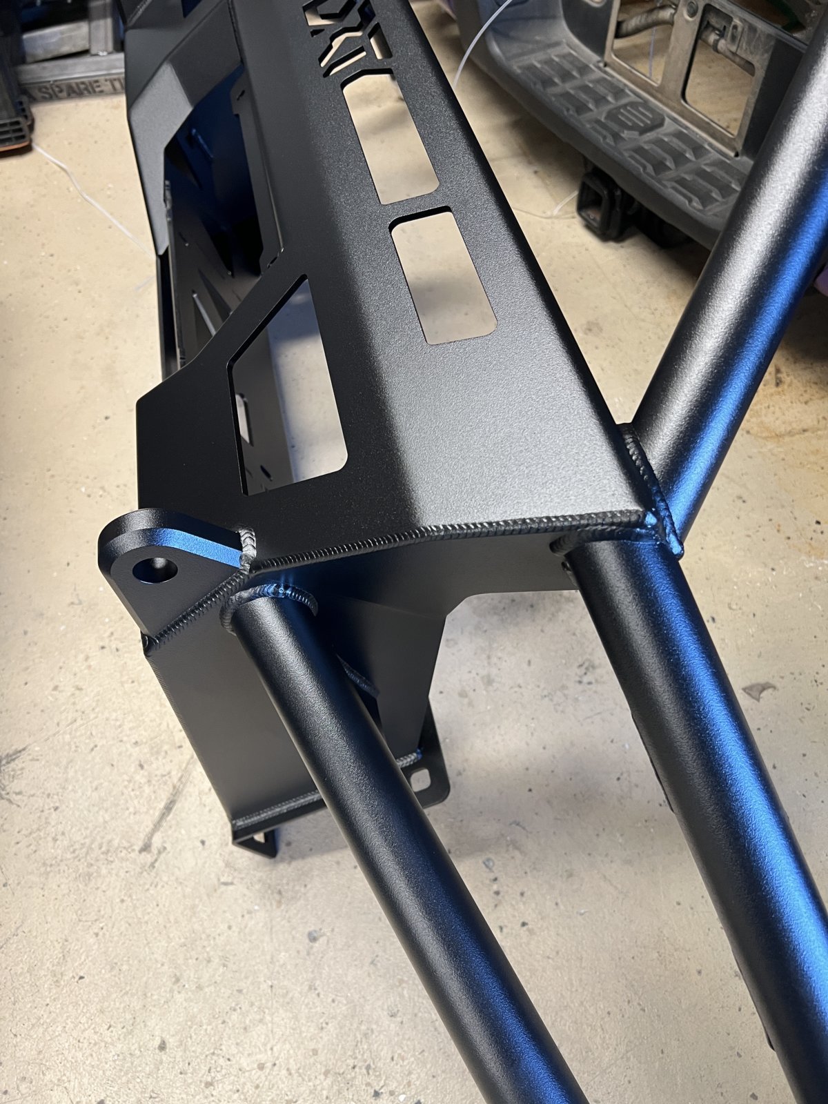

    Now those are some sweet TIG welds. I look at a lot of them.
    You would be surprised what passes for welding these days.
    Your products look to be excellent quality.
    You got mad skills!

    @BillF1564 Thanks man! And this is all mig weld :D
