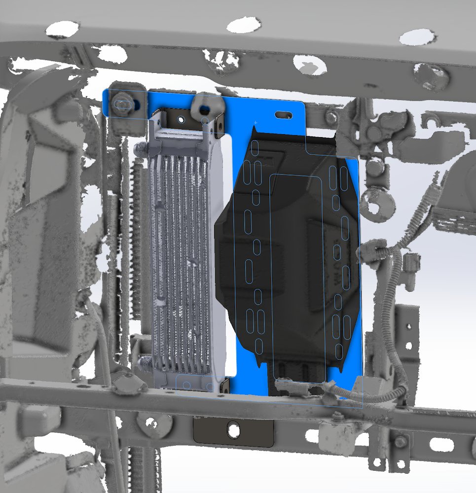

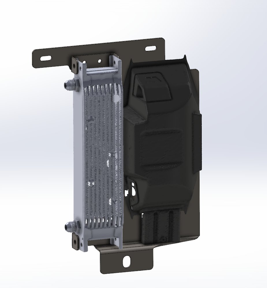

    Some more crossmember delete bumper related stuffs. Winch Control box x Power steering cooler bracket IMG_3918.png IMG_3916.png

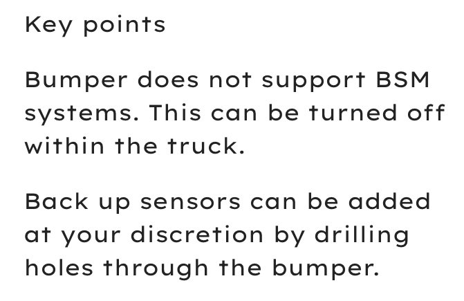

    Same here, the BSM has saved my ass many times when backing out of my canyon-like driveway.
    There are a few threads on relocating the BSM and one where he successfully has them in the tail lights (custom housing).
    Pretty sure all of the bumpers have the holes for the parking sonar…it’s just holes.

    Even the backup sensors require drilling holes.

    Ahhhh didn’t know that was the case with the DRT one, all of the other ones I’ve been considering offer the option for the parking sensor holes.
    Not the end of the world to drill holes but more stuff to do

    I’m working on finalizing all these little things. Accessories for swing outs, back up sensor kit, plug and play wiring harnesses for lights, back up camera Etc.
    The sensors don’t like to stay in the bumpers with holes. The mounting thickness for the sensors is about a 1/16 vs the 3/16 bumpers are.
    I will be doing a bolt on kit that fixes this but also by design I can’t “just put holes” it will have to be a drill and mount solution but I will have the option to have it done by me. My bumper measures 4” tall where the sensors would be. Offering the highest clearance of any production bumper I know of but comes with forming limitations. The sensor holes would deform when the bumper is bent.
    if you choose to add them your self it will come with a easy to use laser cut template to mark out hole locations

    im liking the look of that winch control box relocater. any idea on timeline for that little gem

    Not yet, been messing with it in the computer to get everything happy. It’ll be a bit different than what’s in the pics but same idea

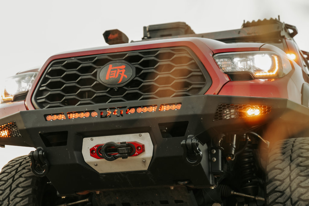

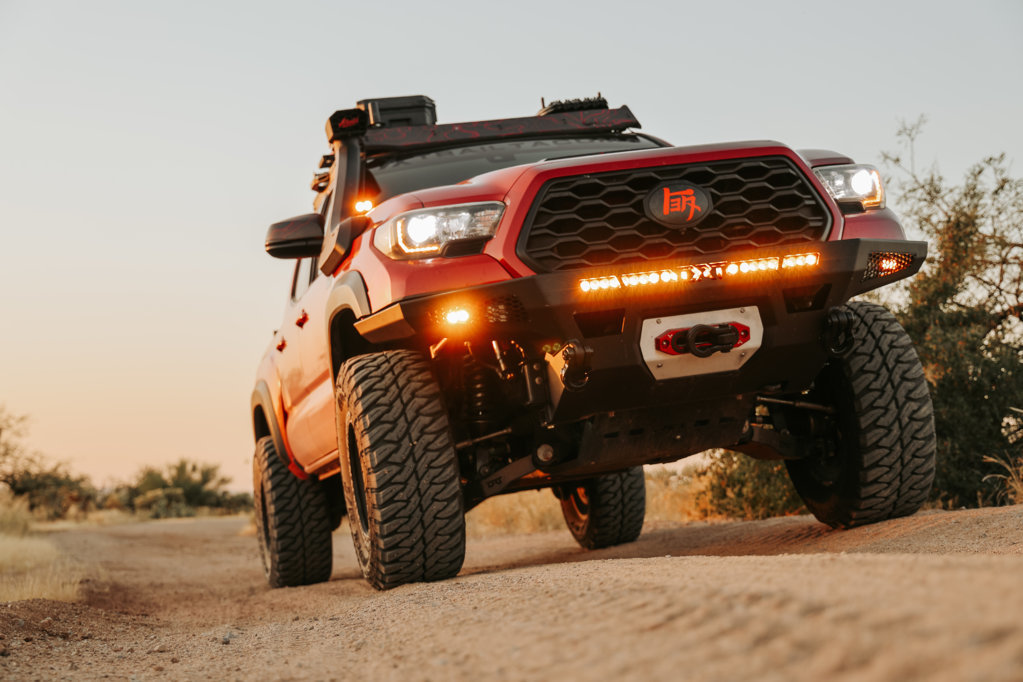

    This new DRT plate bumper is a killer option for anyone who might be thinking about getting one or someone shopping around doing research. For anyone who knows DRT's work, it's top quality and his design is unique which stands out from most options available today.
    I've been rocking this bumper for a short time, but I finally just got it fully outfitted with my winch, recovery shackles, and all the lights it can fit. I just wanted to show this bumper off for anyone who needed to see it and to also help DRT get some more shoutouts for the great work Derik does.
    Thanks for a badass bumper Derik, definitely my new favorite plate bumper for the 3rd Gen Tacoma!
