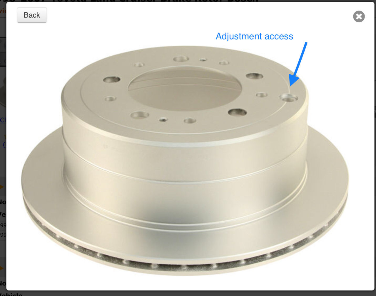

    Here is a picture of the rotor style on the LC.
    The access hole need to be in the DOWN in the 6 O’clock position to access the adjuster wheel.
    Here is video on the adjustment. OP needs to get it to the rotor to turn.
    https://youtu.be/BVMvXoQZKJI
