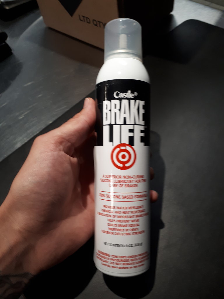

    Finally addressed it this weekend. Used a crosshatch sanding pattern with some rough sanding pads and repainted the rusty drums. All is good at 15k mileage.

    Where do you apply that exactly?

    in and around the affected area :anonymous:

    You mean to tell me you put lubricant on the brake shoe and drum braking surfaces? Tell me you're not serious please.

    Where the shoes contact that backing plate and the wheel cylinder/ adjuster actuates the shoes. That lube may or may not be thick enough to stay put for drums since it's in aerosol form. But you're not supposed to use much anyways.

    It was my understanding the sound is coming from vibrations caused by the braking surface itself. Is that not the case?
