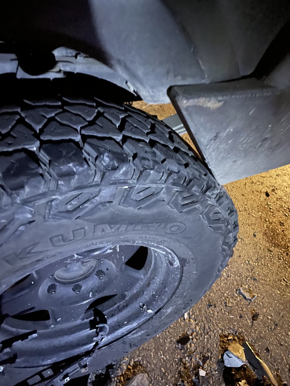

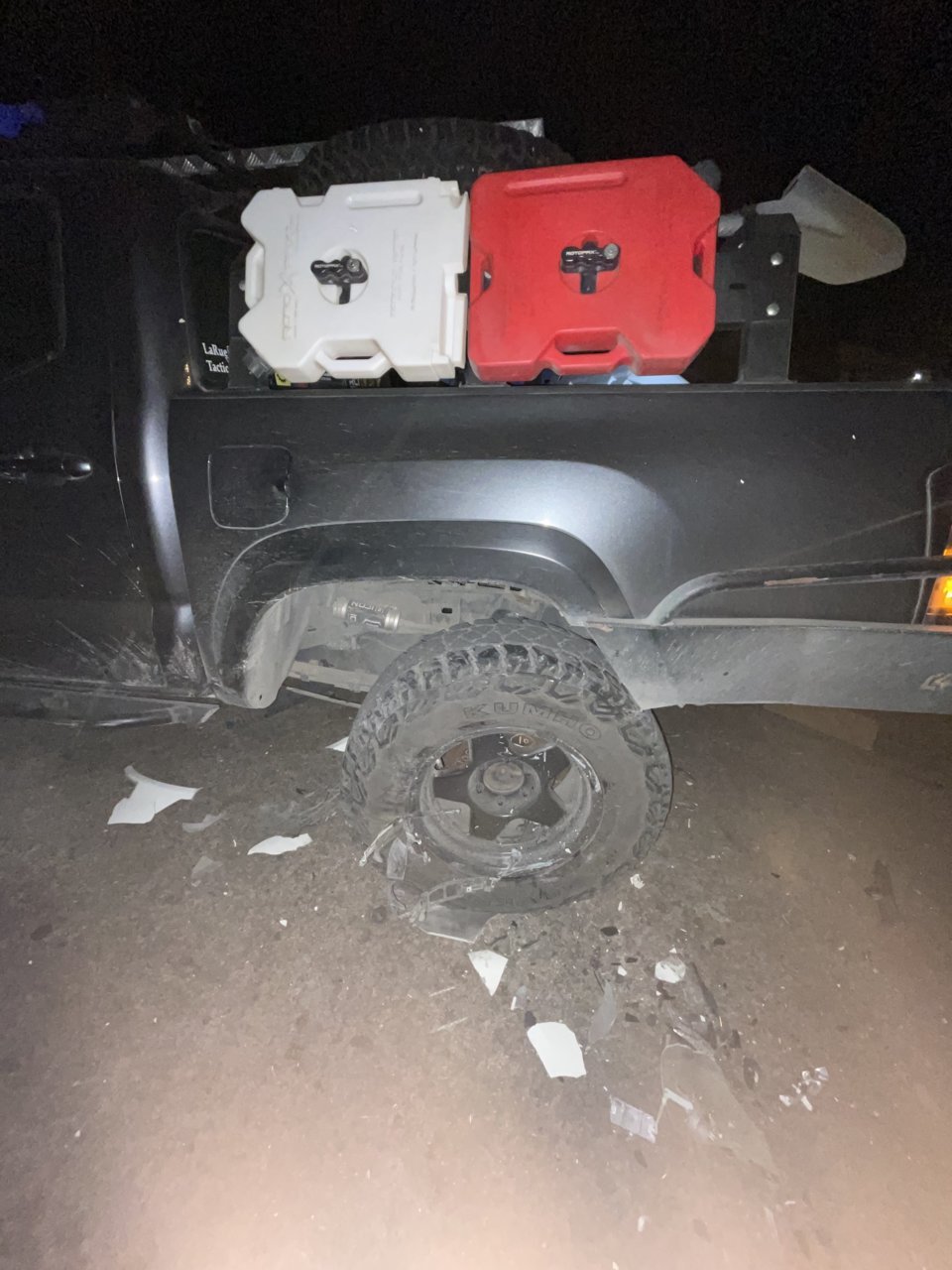

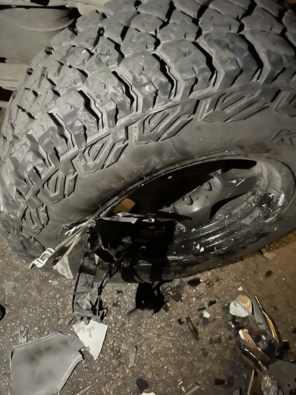

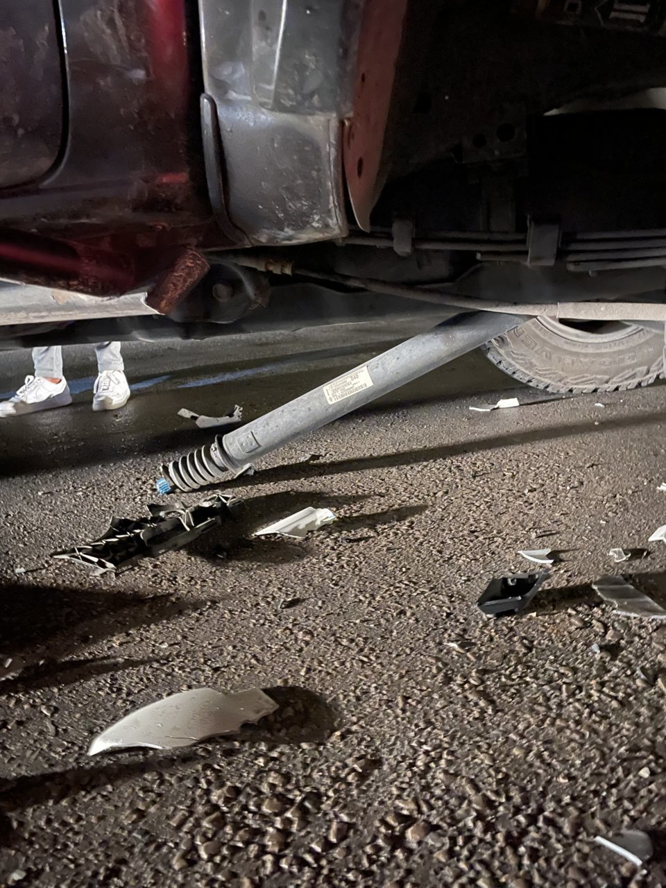

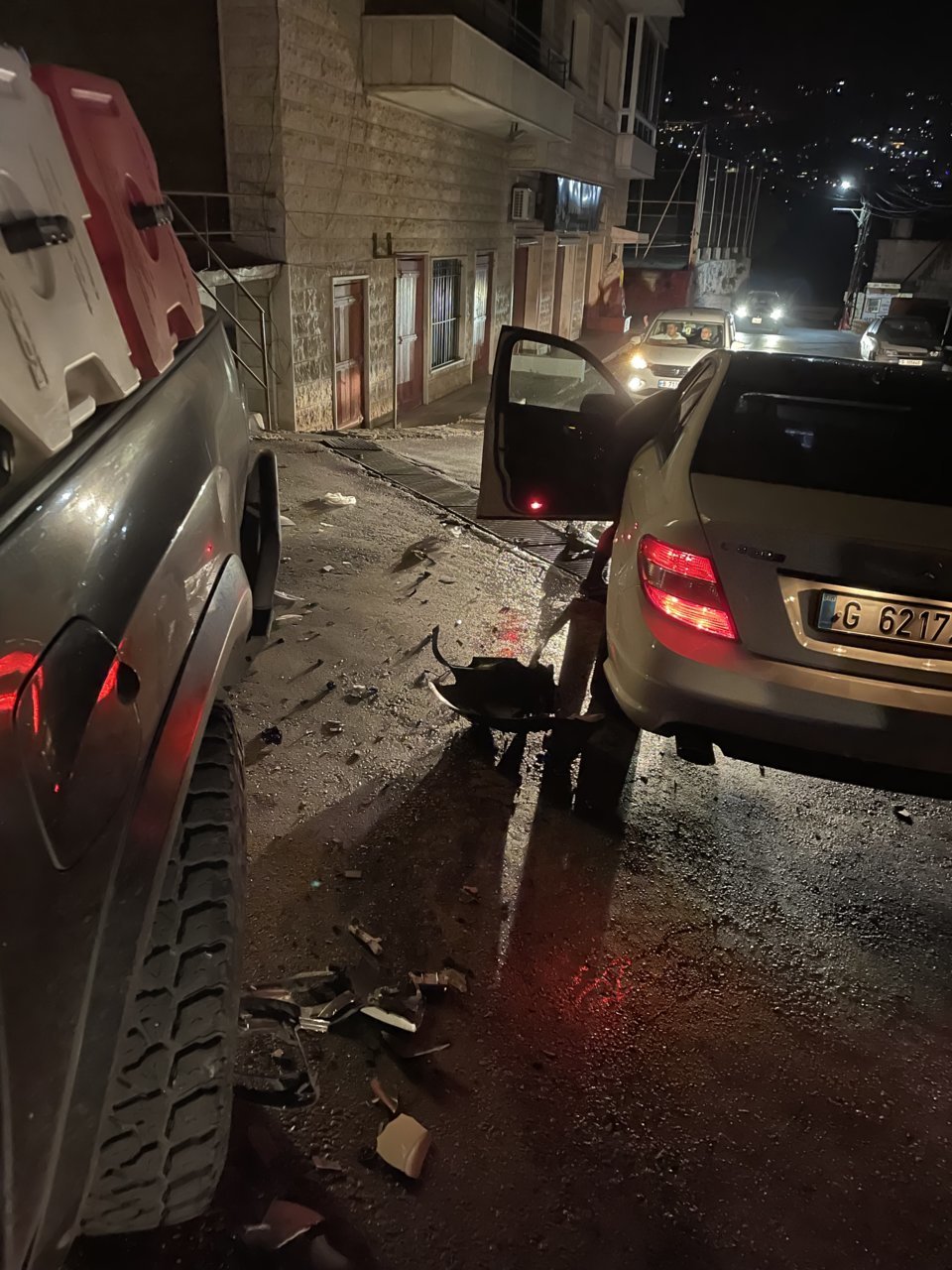

    I mean the pics are blurry and at night. These frames are relatively soft and designed to deform during an accident …
    The c class?! that rammed you looked like it was going at least 40mph… they tore out your entire axle and bent your leaf springs and pulled out your driveshaft … I would be shocked if the mounting points weren’t deformed at the very least, possible diff damage too …
    You also have a massive metal bumper which I think maybe hiding major damage behind it… usually the frame deforms behind the rear wheel and before the rear bumper. Check there first

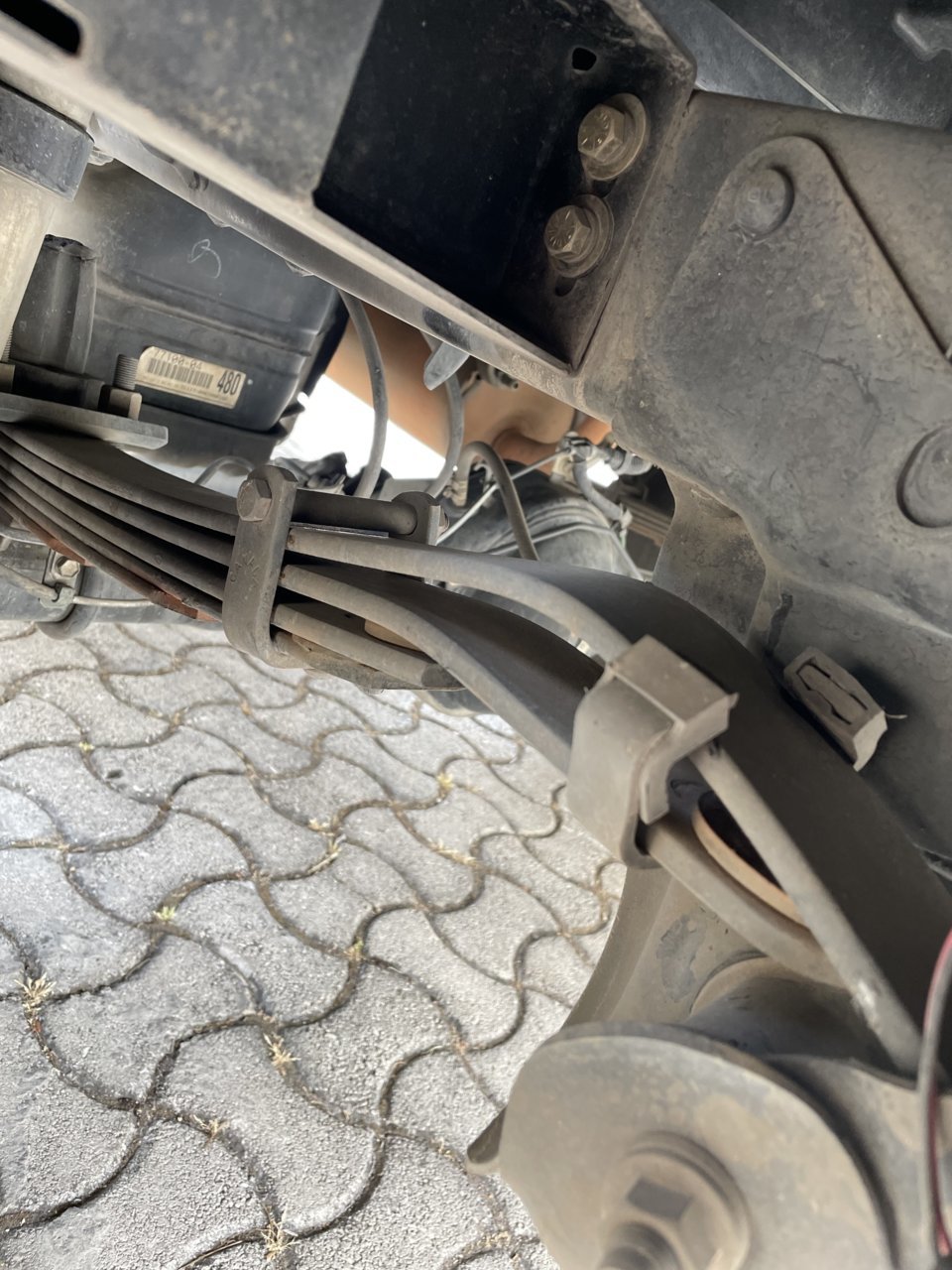

    Check the axle housing, had a similar accident and my housing was bent over 4* between the center and the spring perch.

    I’ll take pictures tomorrow under the truck. Maybe you guys can spot things my mechanic can’t.
    The bumper is touching the fender a little now.

    High clearance bumper? Did he go under it or did the rim take it from the side? Glad you are ok!

    This is what I thought when I saw the pictures. To bend that leaf spring like that the axle tube and perch are probably damaged.

    It's wild to see the leaf spring bent up. Is that factory leaf packs with progressive AAL? I'm so glad your not injured.
