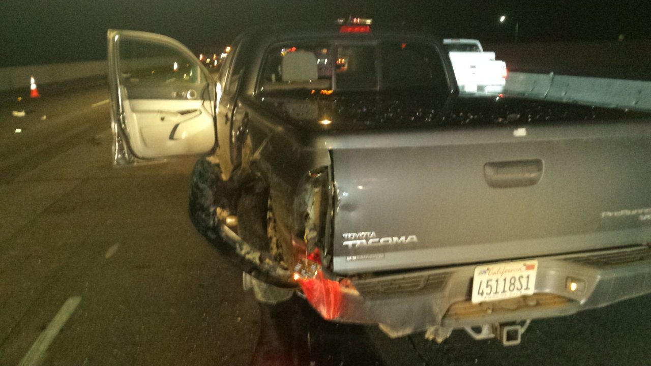

    The frame is busted up because that is the crumple zone. The tweaked section the OP showed is exactly where the frame is supposed to fold in the event of a rear end collision. the bumper is there for minor colisions, ie a shopping cart and wont stand up to much else. The trailer hitch only punched a nice hole In the others car, would have made no significant changed in damage since they were hit by someone going 60 if it wasn't there.

    Ok folks, here's the skinny on truck frames these days. Most are made to be replaced in 3rds. Simply cut out the part you don't want, slide in the replacement and wild it back together.
    Had a similar issue with an f150 that had similar damage. Including cab damage. Insurance paid $15k to section out the rear 3rd of the frame, replace the entire bed assembly and foo the back of the truck cab. Took 2 months and it drove just done.

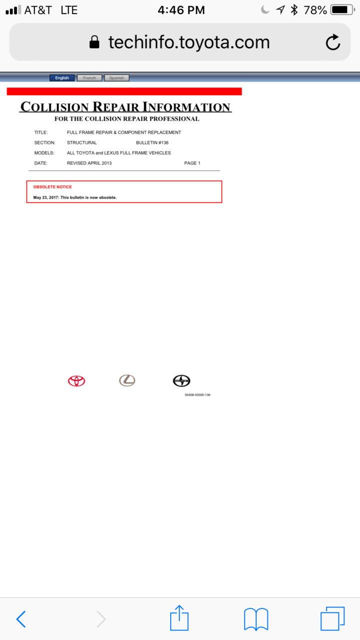

    Hey Jaque, that CRIB is obsolete, you might want to share that with the manager that shared it with you.
    You are correct that cold straightening is the only approved repair method, but the reason that you don’t repair them is because when they are hit in the front they typically buckle in the kick-up behind the suspension, and when they are hit in the rear they link right I front of the hitch like the OP’s

    I don't even know if that was the right one he just told me there's a CRIB covering it and thats what I found with a 5 second google search, but don't think it changes anything.
    Do you have anything that says they now allow heat/sectioning/welding for frame repairs?? Because THAT would certainly change things.
    Edit: nevermind you stated in your comment it doesn't change anything. So I guess I don't understand your point lol. Anyways I guess we all agree Toyota doesn't allow otherwise common in the industry frame repairs at their certified bodyshops (which was the original point)
