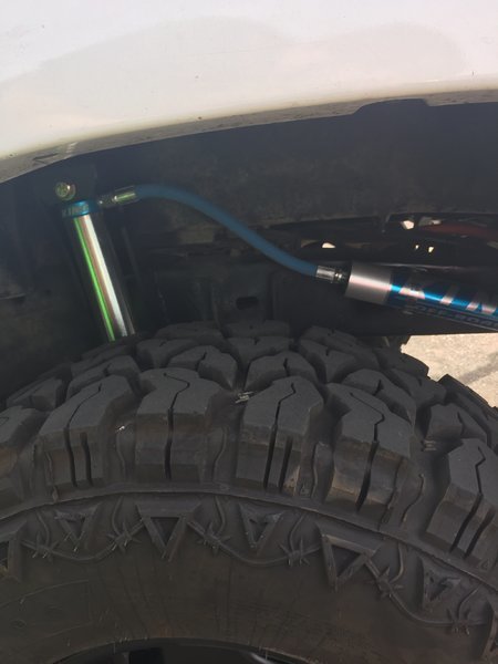

    #134
    GARSHA91
    GARSHA91 YES, that is me on that Facebook group
    Sep 30, 2013
    #113559
    3,044
    Chicago
    2015 TRD Off-Road DCSB
    Just a grocery getter
    image.jpg Both are great!
