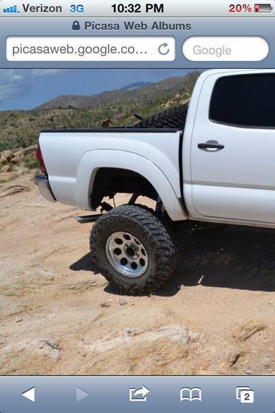

    not even CLOSE to full droop with my 12's!!
