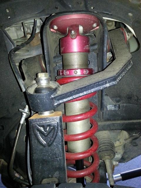

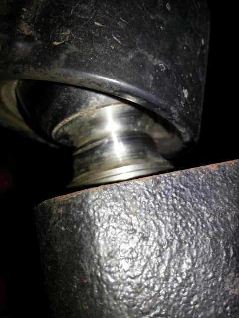

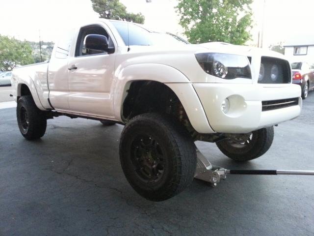

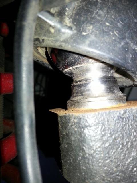

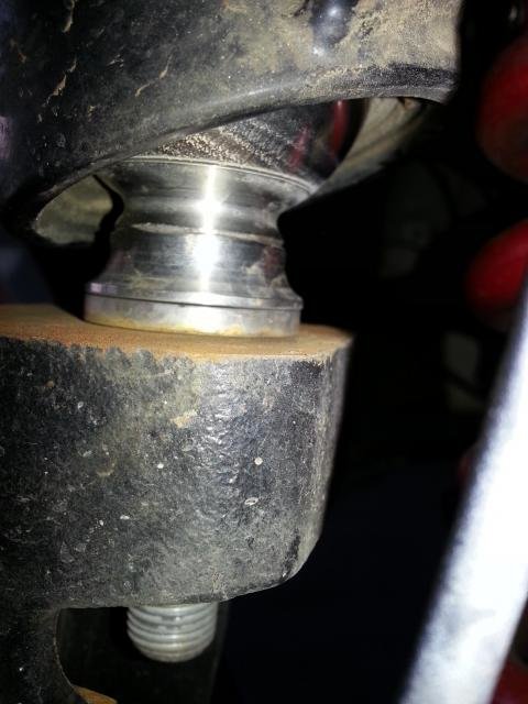

    Finally got around to doing this after an 80 hour week. The wife picked up the misalignment spacers from DSM a couple days ago, thanks DSM.
    Pic for reference at full droop. Drivers side looks like it's touching the ground but it isn't, tire is able to spin. The ground is uneven.
    20140720_195928_85408ae81e2c0f5ea4ecfb81d196787bf635c6ff.jpgDriver side
    20140720_195800_2730f5c92b5b04630936ccf1f39c8cbf869e04d9.jpgPassenger side. Damage only on the rear of the spacer
    passenger side again
    What do you guys think? As we can see the control is not making contact w/ the spindle head.

    Hmm. Can you remember if the Snap ring is close to where the damage on the spacer is. ? That's all I can think of it really being. Even then it's still odd.

    No the snap ring is not close to the damage. But like your comment earlier SDHQ, I feel it's too much down travel and the uni ball is 'pulling' down on the misalignment bolt tearing the mettle. Crude way to explain that but hopefully makes some sense.
    I'm off today, was going to give Trac performance a call and see if they can cycle the suspension and strap it. Another set of eyes always helps, not to mention they're local.

    In this picture, is this the new spacer that has damage? and if it is only on the back side of the spacer, would it be a up travel issue?

    Nope. New spacers are sitting next to this laptop. I'll leave them off till I can remedy this issue. Don't feel like damaging new parts :)
