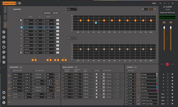

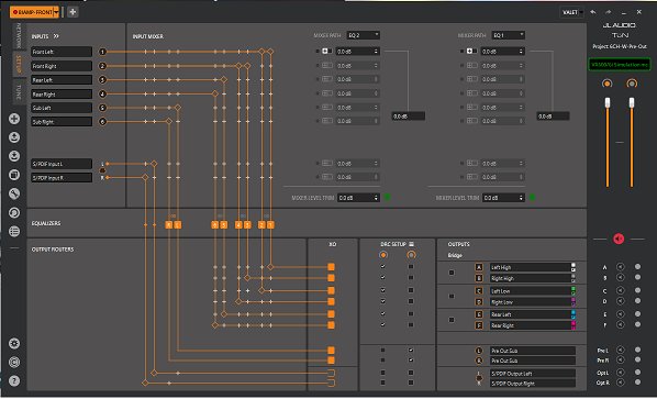

    Since DSPs are on the menu here, I'd encourage anyone interested to download the JL TuN application and experiment with it in Simulation mode, so you can get an idea about how powerful it is. I downloaded several DSP software applications from various developers and I really came to like the one from JL. Getting this kind of flexibility used to be unaffordable for consumers, and there's a LOT of professional gear out there right now running huge sound systems that can't do a lot of the stuff this does at more than quadruple the cost.
    http://www.jlaudio.com/Info/TuN+DSP+Software/Discover+TüN™+-+JL+Audio’s+DSP+tuning+software+for+the+PC+platform!/8096706
