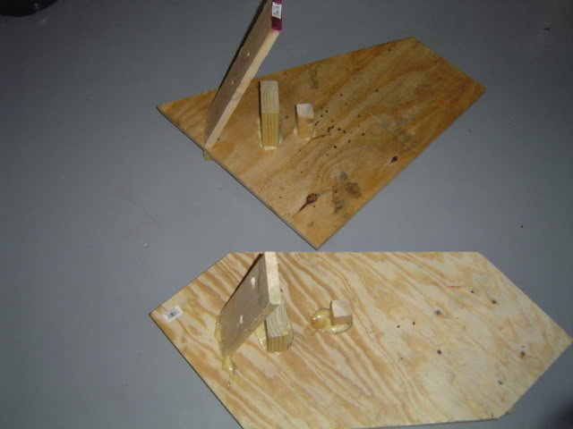

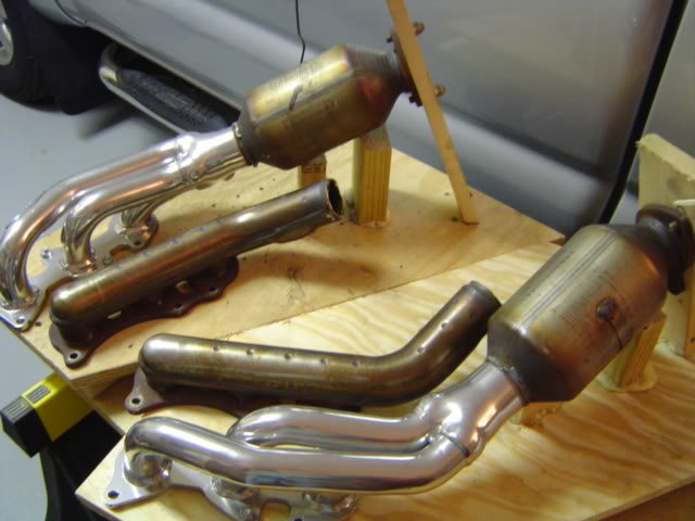

    DT shortie headers
    I live in Texas and I like to stay emission legal. I also like to keep the O2 sensors so my fuel economy won't suffer. Here is my DT shortie headers.
    1. I created a form that supported the old manifold using plywood. Make sure the manifold is bolted down securely. You want to make sure the bolt holes in the new header lined up well.
    2. I then cut the manifold at the weld line before the converter using an electric cut-off tool or hacksaw.
    3. I then removed the old manifold from the plywood and bolted on the shortie headers to the plywood.
    4. I then had the local muffler shop weld the header for me. DSC01350_e76a4ee245785f12c950f6490d835bf329c7e8ba.jpgDSC01361_7fa7868e431d0bfb0f8cd4bf34b72edbff64ff0f.jpg
    On a side note, comparing these pics to my JBA's sitting in the garage, I have to say Doug Thorley's look of higher quality. By far:cool:
