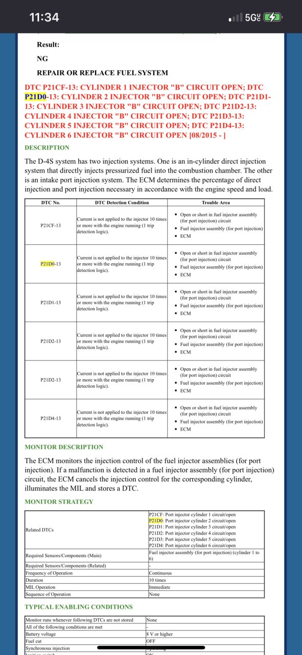

    Didju do a visual inspection already? Looking for mice n stuff? I think your instinct is correct. That it's the port injector and after u get going the direct injector is taking over. Although I have no proof of that.

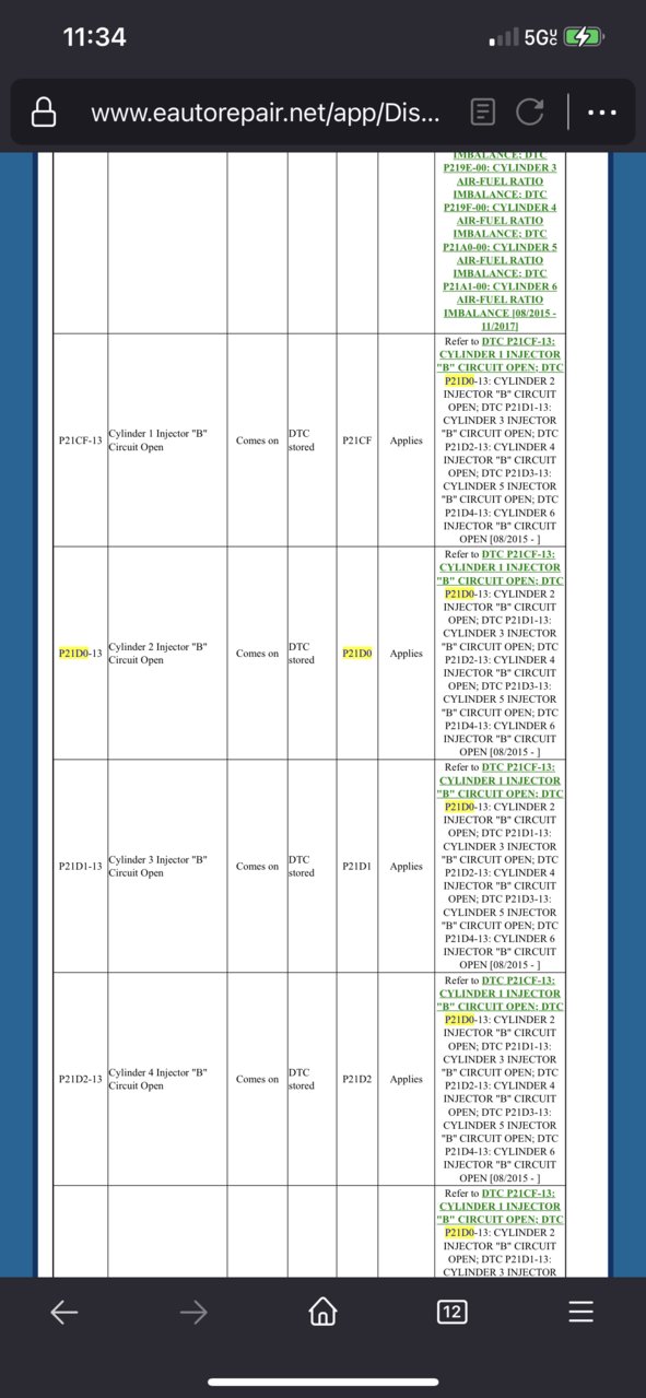

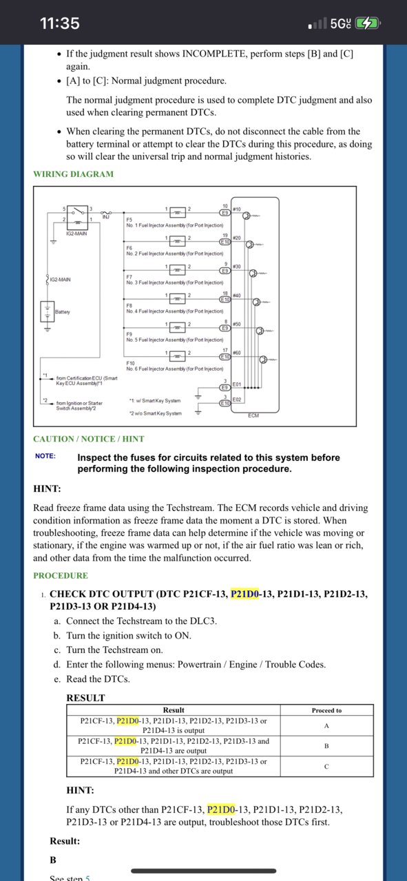

    Idk if these help.
