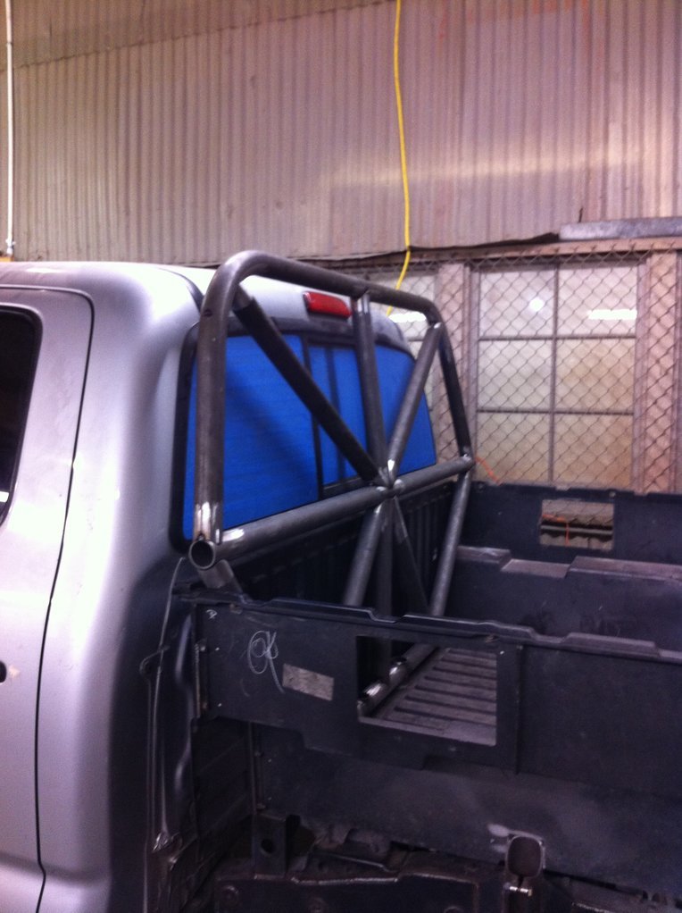

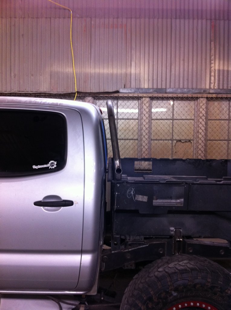

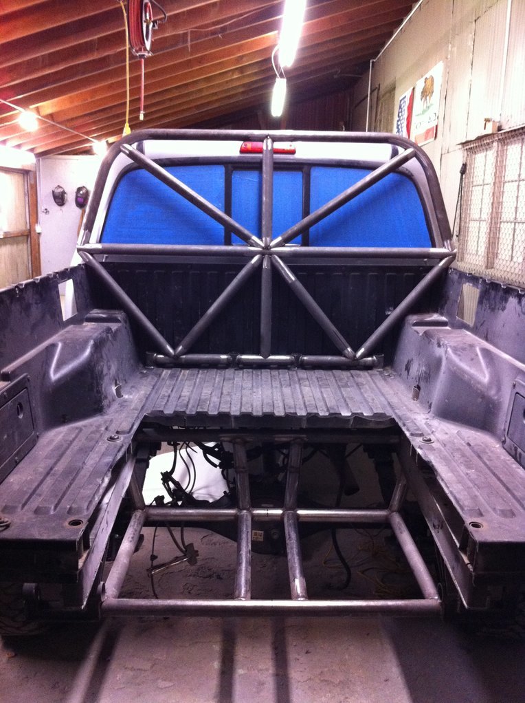

    I had gnar week got engaged on Monday, hung out with the lady on tues, built the top portion of the hoop on weds, and did some coil testing on thurs, worked at the Fed building in LA on Friday, did more electrical work at my pad on sat, and left for 29 palms on Sunday and now I'm working here for 3 weeks :eek:
    I'm bored now lol

    Congrats on the engagement man! Im sure its already been covered, but what are you doing (or have you done) to the rear? 4-link?

    Congrats on the relationship mod man! ;)
    I can only imagine how the parking lot will look like at the DTF wedding lol.
    Bed cage lookin legitttt Antokneeeee

    Thank you! The rear end is a 50T pack with a custom inverted shackle that's gonna be strapped at 18"
    Yeah man I can't wait ........for the bachelor party hahaha!
    I'm gonna tie it into the frame in couple more spots. Nice and over built but you know how that goes.

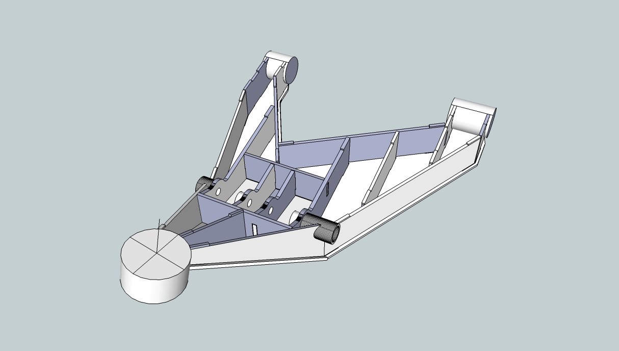

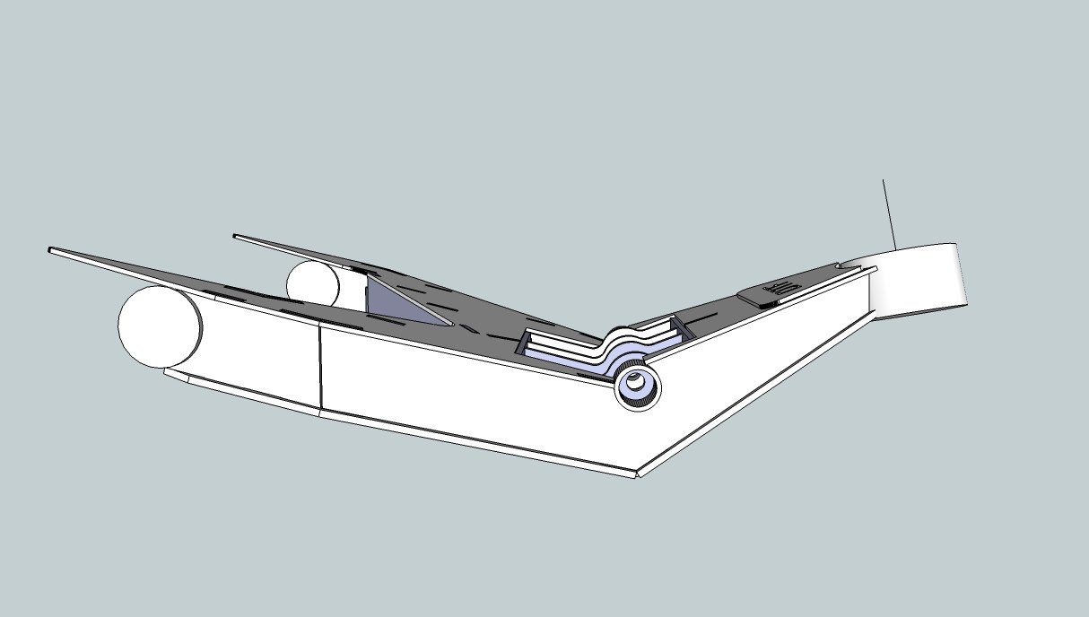

    So I've been here in 29 palms and bored so I made some changes to my LCA so here is 2.0
    Major changes are
    uses (2) 1/2" x 3" bolts instead of one 9"
    Reduced the amount of internals so less time welding
    Made more interlocking parts so less measuring and easy fitment
    Cleaner looking lower shock pocket
    Changed the upper plate to 1/8"
    Broke the lower into (2) pieces
    Built in wrap on the top plate
    Found a spot for my logo :cool:
    Most of all the got rid on all the bugs from my previous model! :D

    :drool: holy shit those look sick even on a computer program
