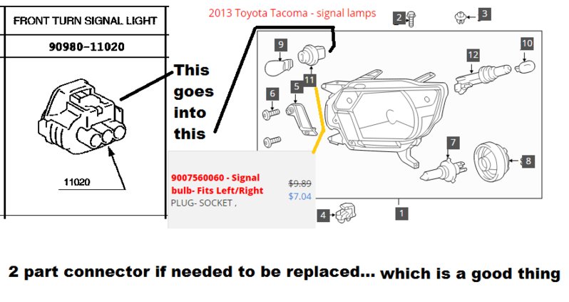

    One of my DTRL bulbs burned out. When I went to replace it, I found that the bulb socket has heat damage. It's brown and brittle, and one of the clips broke. So, a new bulb cannot be held in place. Where can I source a replacement socket, and how easy is the swap? I tried searching this topic, but I wasn't able to find anything relevant.
    Thanks in advance!

    Is it this one?

    Yes, that looks like the one, if I remember correctly. Is there any splicing involved? Or, does that "2 part connector" thing make it an easier replacement?

    it is way easy...no splice.
