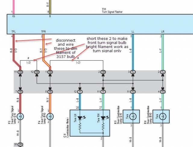

    I doubt there is anything proprietary about the instructions and highly doubt there is a utility patent for it, so anyone can share it if they choose to. There are many ways to wire a dtrl switchback. If you understand circuits it will be pretty straightforward once you have a wiring diagram.
    This is the general idea.
    post questions if you need more detail. there will be people who will help willingly and not hold back info.

    I 100% agree with Toyota's circuit design to use the bright filament for both DTRL and turn signal. The dim filament is too dim to be useful. The only flaw was component was not able to handle the heat, for which they correctly fixed. Notice they did not fix this by using the dim filament, but instead continue to use the bright filament only and fix the housing. I think toyota did the right thing.
