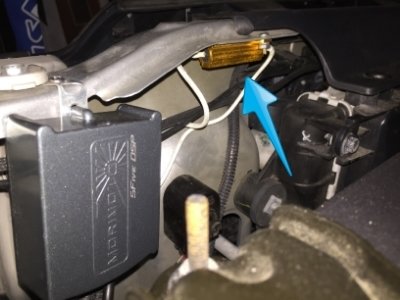

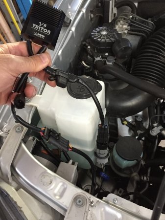

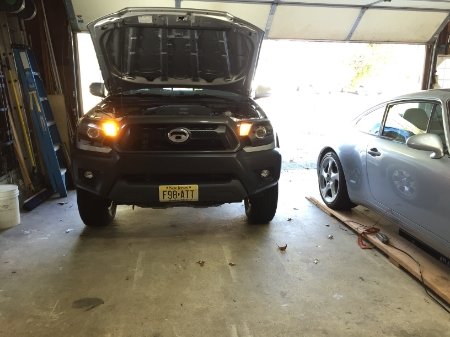

    running resistors up front sucks. they are scalding hot all the time. loading the circuit, all the time. plus the LEDs that are out there are really dim for this application.
    get VLED Triton set up for up front, the resistors will only be online when you activate the signal. they are as bright or brighter than stock.
    jumpers led on drivers side, VLED on passenger
    no affliation, just a very satisfied customer after playing the LED game with the tacoma....

    Congrats. on the install. IMHO resistors in the front must be mounted to solid metal to dissipate their heat, especially away from the wiring harness; they'll get as hot or hotter as a regular bulb (26-28 watts each) while DTRL's are on. If they can be in the regular airflow of the fan, it will help.

    i only used load resistors in the back at rear signals. my tritons up front did NOT have resistors activated. in fact the new tritons (v3) dont even come with built in resistors. if you needed them youd plug them in. my v2's were run without the fuse present that activates the resistor. i didnt know this until installed them in another vehicle. regardless, if you use the triton kit, its only putting the resistors online when necessary.
    a good place to mount resistors up front is on the horizontal metal crossbar of the forward engine compartment. having said that, i was glad to remove them and not use them anymore. the system sucked. they were dim and who wants those things boiling away all the time.
