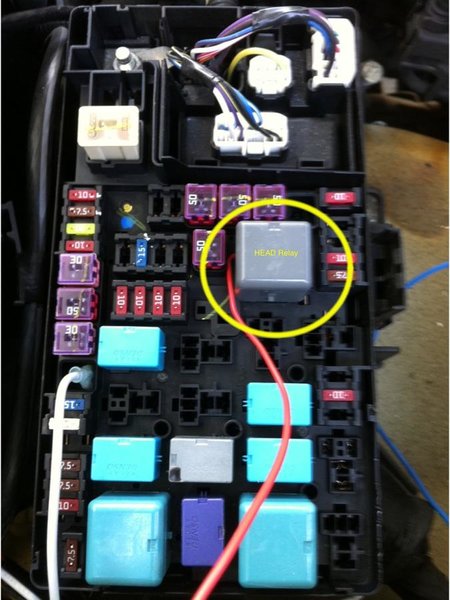

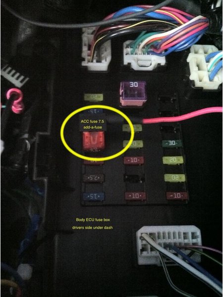

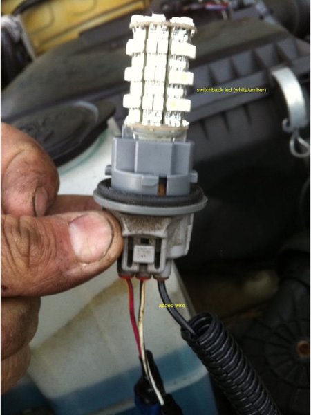

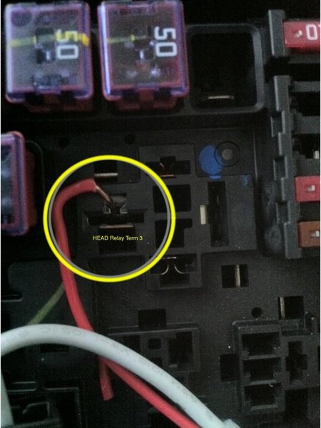

    This is how i wired my DTRL putting the resistor across the turn signal wire and ground

    holy crap, I've been wanting to do this for a while and didn't seem like it had been done and couldn't figure it out! I can now put switchbacks in and wire dtrl
