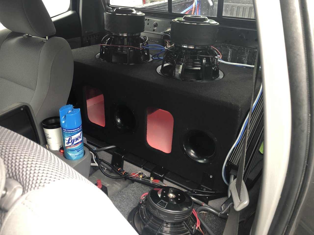

    I am into car audio and high powered amplifiers around 10,000 watts require about 700amps at max draw. I actually had one that I sold because I thought I would never be able to use it in the Tacoma. :annoyed:

    My ham radio and inverter would kill my battery pretty fast with a 270dx alt and one battery. Adding a second battery would only let run a little longer.
    I pulled out that gear and now am working on a big system with my son. We will use all that power and still need more.
