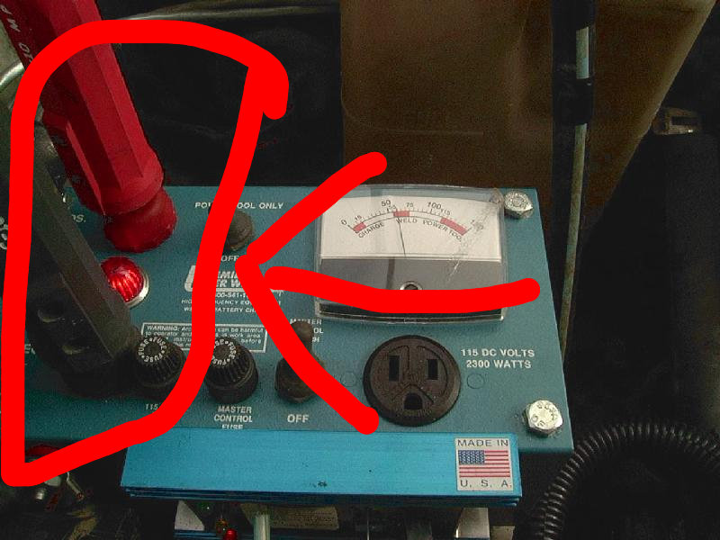

    Yes but I haven't found anyone that has done it Like I'm planning- to be more clear, I want to wire in leads from the main battery back into the bed Into two flush mounted quick disconnect plugs like you would find in a welder
    Then I'll make a battery tray in the bed and bam dual battery when I need it, and no need to get an expensive compact one that'll fit under the hood
