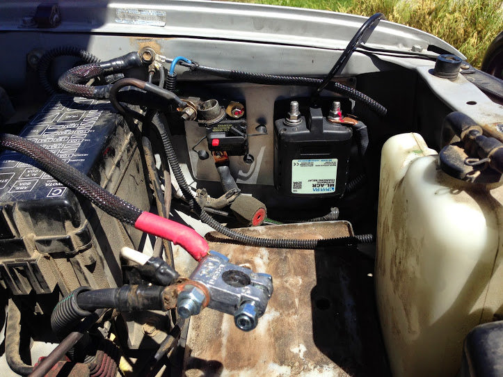

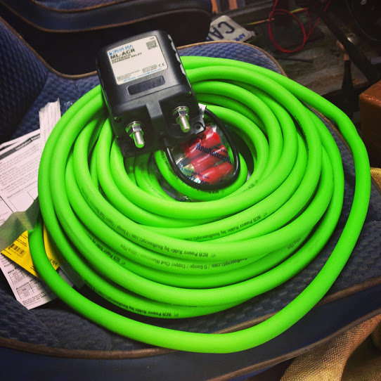

    heres the crap i used.
    blue sea ML-ACR isolator, some 00 ga wire and a 150amp circuit breaker.

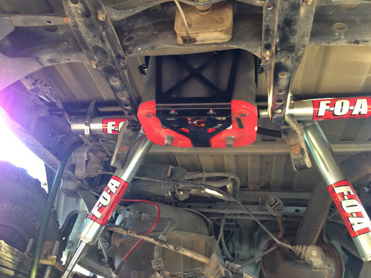

    mounted it on a plate next to the stock battery location.
    and mounted the battery under the bed.
