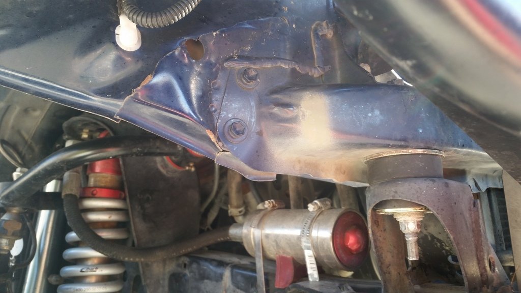

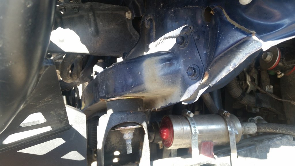

    If you relocate one to the passenger side fenderwell or wherever, something like this could happen:
    My own vehicle has it elsewhere obviously
    Exibit A, upoer right corner:
    Exibit B:
    My point is, don't do it. It's not worth the impending headaches to follow later on.
    I'm a 2012 for the record. Again, I do offroad pretty hard, but this can and will happen in time whether you do or don't, street duty/ mild offroading/ hard high speed offroading..

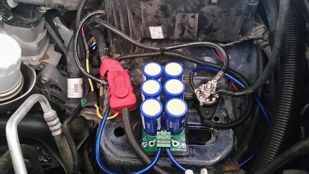

    Oh no. The new setup is working beautifully. Not a peep out of it minus some weird little electrical bugs from the AFR meter and the radio restarts my song every time I start the truck, but that's it. I may use my small capacitor bank to supplement the electrical after I can figure out how to encase in a weatherproof and solid mounted setup and run it in between the two access terminals, but I'm lazy to work on the truck as of lately.

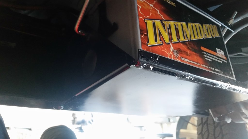

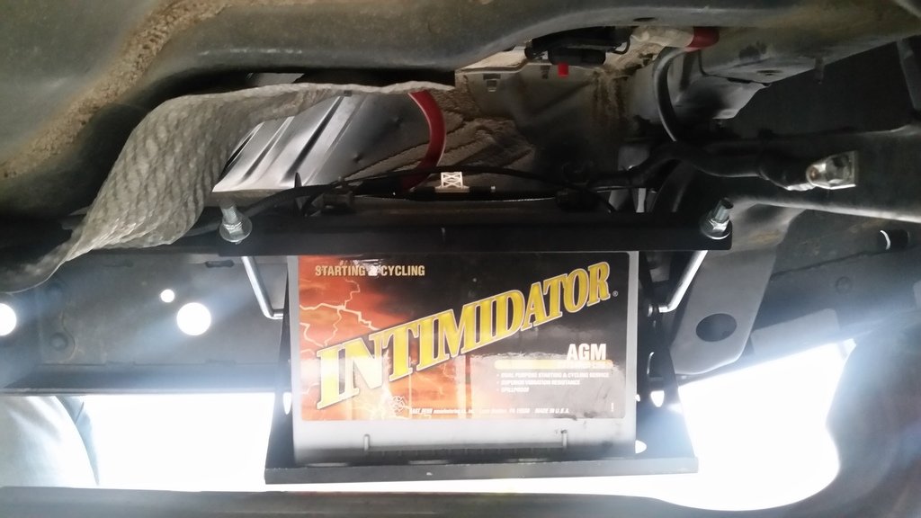

    The firewall? You are asking for it if you do. I don't know why you even rationalize that as an option. Not to sound dickish man because I'm not. I'm just trying to save you guys headache down the road is all.
    To answer your question though, if you put the weight on the firewall or by the rear of the firewall, you will suffer the dreaded splitting firewall most of the FJ guys encounter. We don't seem to have that problem, as ours seems to be a bit stronger or better structurally built than theirs, but it will happen with all that weight back there.
    Best option to go is either A relocate to the bed, B relocate to the frame as I have done, or C just get a super lightweight battery.
    This is my setup. Incognito, inconspicuous, easy to work on, street daily approved and high speed dune jumper approved as well. VERY strong!

    No that's way to big. The capacitor bank weighs no more than a few ounces. Definitely less than a pound, but it packs the punch that I need to stabilize the electrical system. It's just bare and uncovered, so any water or moisture that gets onto it can potentially make it act funky until it dries up.
    This is what it looks like, but I had to pull it out for obvious reasons.
