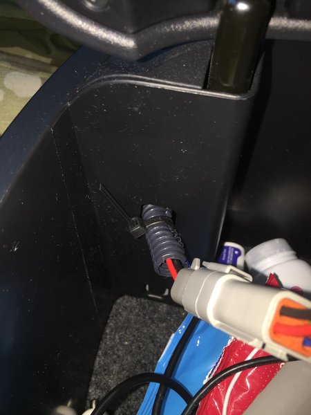

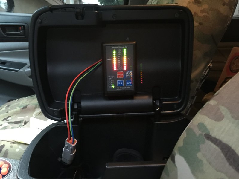

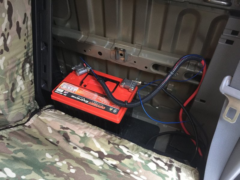

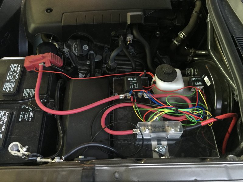

    I have the IBS installed, and have put my second battery behind the left rear seat after removing the plastic storage tray. All the wiring is temporary, shortly I plan on:
    -Making my own battery cables, using 1GA for main batt to house batt positive and ground wiring
    -Using 4GA for wiring a circuit breaker, fuse block, and shunt for monitoring voltage and amp draw from the fuse block
    -Using the holes provided on the back wall of the cab to mount a sheet of acrylic or wood to mount my fuse block and associated wiring on
    -Trimming all the IBS system wires to size and properly crimping and sealing them now that I have test fired everything
    -Upgrading my main battery wiring with a setup from BamaToy1997
    -Still working on a way to secure the Odyssey to the back wall of the cab
    I have almost everything I need on order, will post my progress.

    Nice - I am about to add a dual battery to mine with the IBS, I've decided I am going the same route as you and putting the battery in the cab, most of the electronics are in the cab or are out to the back of the truck so having it all inside made sense to me.
    Did you ground your second battery to the frame and if so where did you penetrate through?
    I also see you decided on placing the monitor under the lid, were you going to run the wires inside the console body?

    Yea the second battery and fuse block in the cab made sense to me as well. Especially since I have some additional lights to add to the roof and shell soon.
    Currently I have my aux battery grounded back to the body ground right next to the main battery, running right next to my positive wire to the aid battery, which I don't consider ideal or long term. I am working on a big 3 wiring harness upgrade and maybe once I get a multimeter on everything post-install I'll ground loads to that.
    I am going to get an a bolt welded to the frame under the back of the cab for more grounding options, I don't like a ground that long. There are some rubber plugs on the back wall and back corners of the cab for running wire through.
    There was a hole already in the console for me to run my monitor wiring through, with the wiring going from under the center console to under the drivers seat, then hid under the foot paneling for the left doors. The firewall wiring plug has plenty of room for feeding your wiring through to the engine bay.
