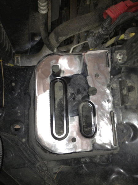

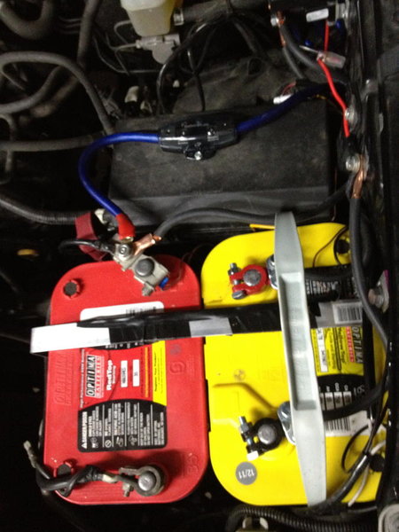

    Ask and you shall receive
    First i ground down the paint and remove the factory battery

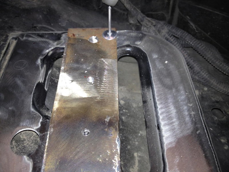

    Then i riveted some bar stock to the stock location

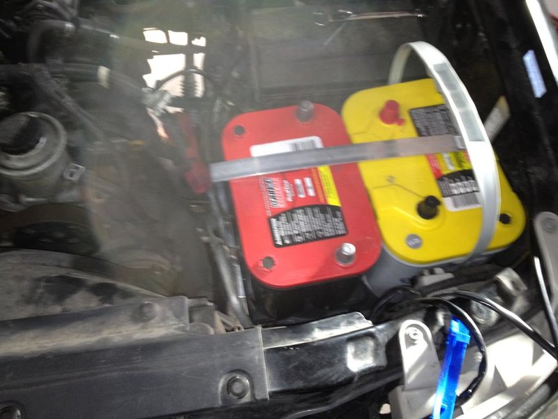

    Test fitting the batteries
    Wired up

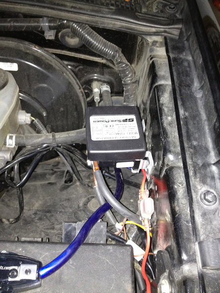

    And the isolator
  13. Apr 1, 2012 at 9:10 PM

    Thanks Craig! I'm going to redo the battery tie down though, I had one slip and ground out while driving which shut the engine off. I got it fixed and hasn't happened again but i need something a little more secure.

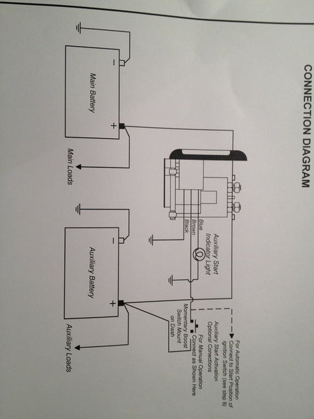

    Got a link to a wiring diagram for that?
    I'd take a whack at that. :cool:

    Yea I'll post it up in my build thread or PM it to you or both.
