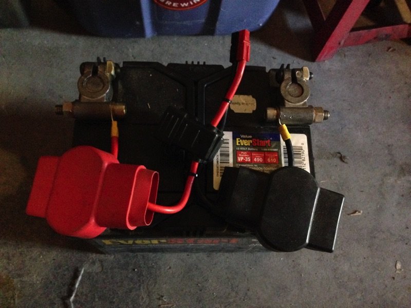

  8. Dec 27, 2019 at 5:06 AM
    DaveInDenver
    DaveInDenver Not Actually in Denver
    May 18, 2013
    #104390
    3,619
    David
    Grand Junction
    2008 Super White TRDOR AC 6MT
    Unexceptional
    FWIW, if you use a common terminal for all your accessories you can mix-and-match. I use Andersen Power Poles on all my 12V things, ham radios, solar panels, chargers, fridge, etc. This is a roughly 600 watt-hour "Goal Zero" that cost about 1/4 what it would with a brand name on it.
