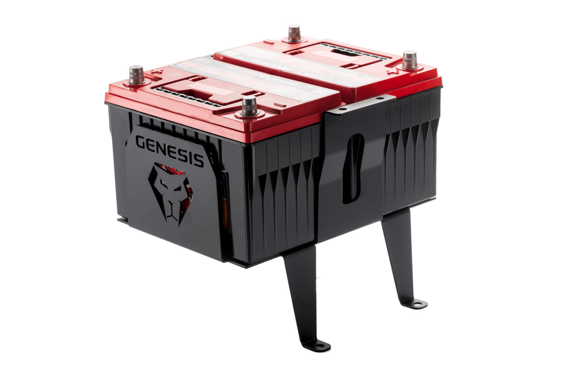

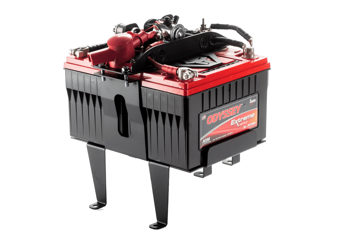

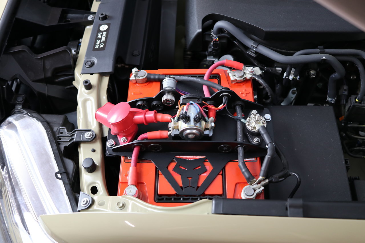

    Our kit uses the Cole Hersee smart isolator. It is designed to protect your cranking battery from being drained by your accessories. When it sees your cranking battery above 13.2v for 2 minutes, it will automatically link them together so the aux battery can be charged. They stay connected together, giving you the combined capacity of both batteries to run everything, until they drop down below 12.7v for 1 minute. Then it will automatically separate the batteries, and all the accessories that you have connected to our built-in power & ground bus bars will continue running from the second battery, and not drain your cranking battery. Then we take it a step further. If for some reason your cranking battery gets drained too low to start the engine, you can press the boost button to manually reconnect the batteries to jump start yourself from the second battery. Our kit comes all completely pre-wired out of the box, so there's no wiring for you to do at all. I know some people are concerned about the extra weight on that side, but the incremental weight is only about 50 pounds, and our battery tray is designed to spread that weight out over a larger area. By keeping the batteries together in one tray, it simplifies the installation process, reduces complexity, and leaves the area over on the passenger side available for other stuff like an air compressor or whatever else you may need. Our kit uses Group 34 size batteries, and we use the factory post clamps so it's completely reversible if you ever need to put it back to stock.
    Best of all, our kit is only $519, and we keep these in stock for immediate shipping!
    Here's a link to our detailed installation video on our youtube channel, and some more pictures. If you have any questions, feel free to call me - I'm Shane Smith, the owner of Genesis Offroad - 901-214-5337 or email info@genesisoffroad.com. More details on our website, www.genesisoffroad.com
    HPPH, RatDaddy, mike113001 and 22 others like this.

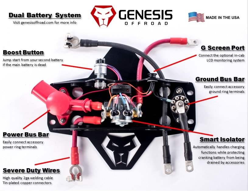

    Is the manual override to jump start yourself in the cab or under the hood? As I understand it the OGE setup automatically switches to jump start your battery if it's too low to crank which is a nice feature, but likely not mandatory for my needs.

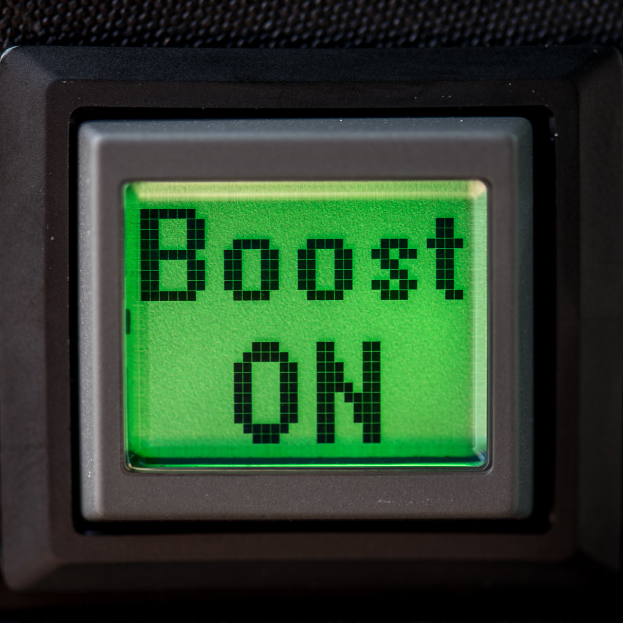

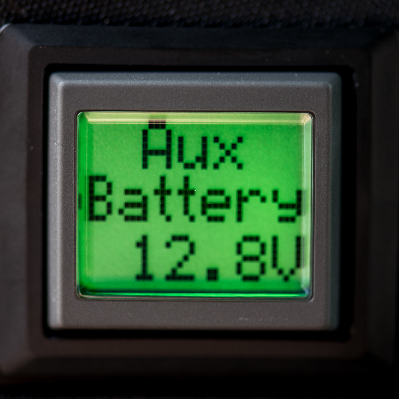

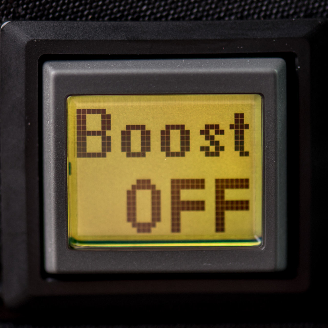

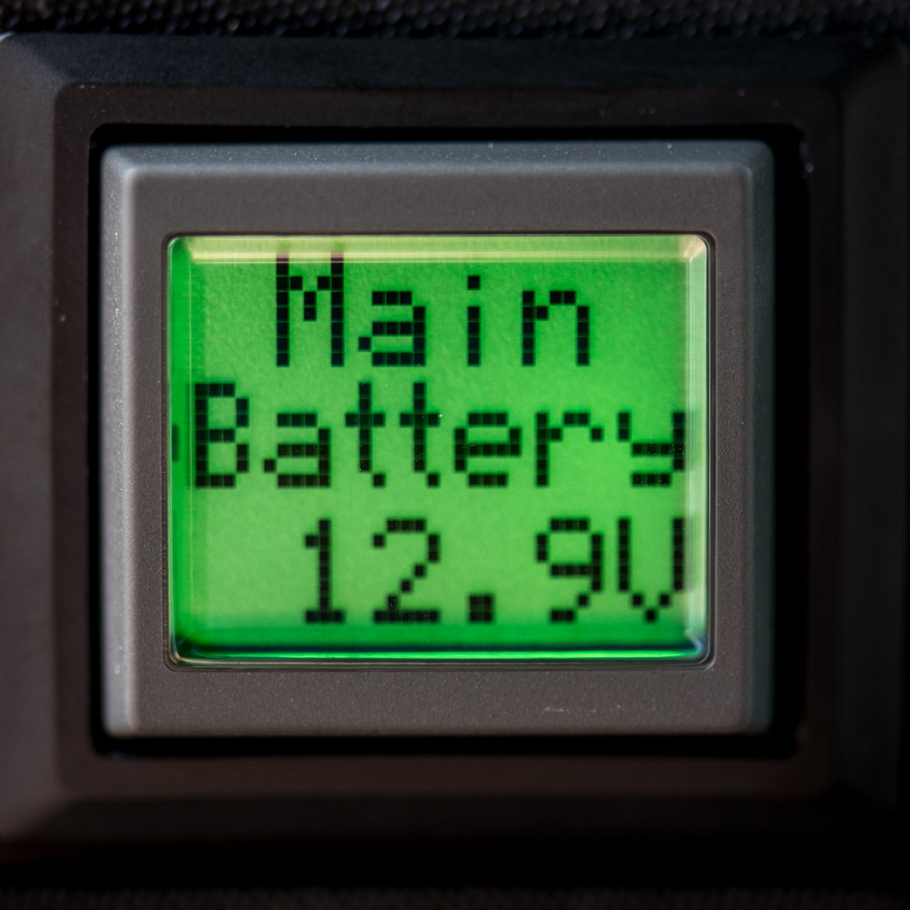

    Excellent question! Our kit has a boost button built into the kit under the hood. Here's a picture showing it better.
    So if you get in and try to start the engine and find the cranking battery is dead, you can hop out and pop the hood and press the boost button one time, and that gives you about 1 minute to start the engine before it automatically separates them again. You can also use the boost feature from inside the cab if you have our G Screen monitoring system. This is a 1" lcd screen that you can put inside that will show you the voltage on each battery, and it tells you if the isolator has the batteries connected (Boost On, green backlight) or if they're isolated (Boost Off, yellow backlight). From the Boost Off screen, you can hold that screen down for 3 seconds to trigger that boost feature without getting out of your seat!
