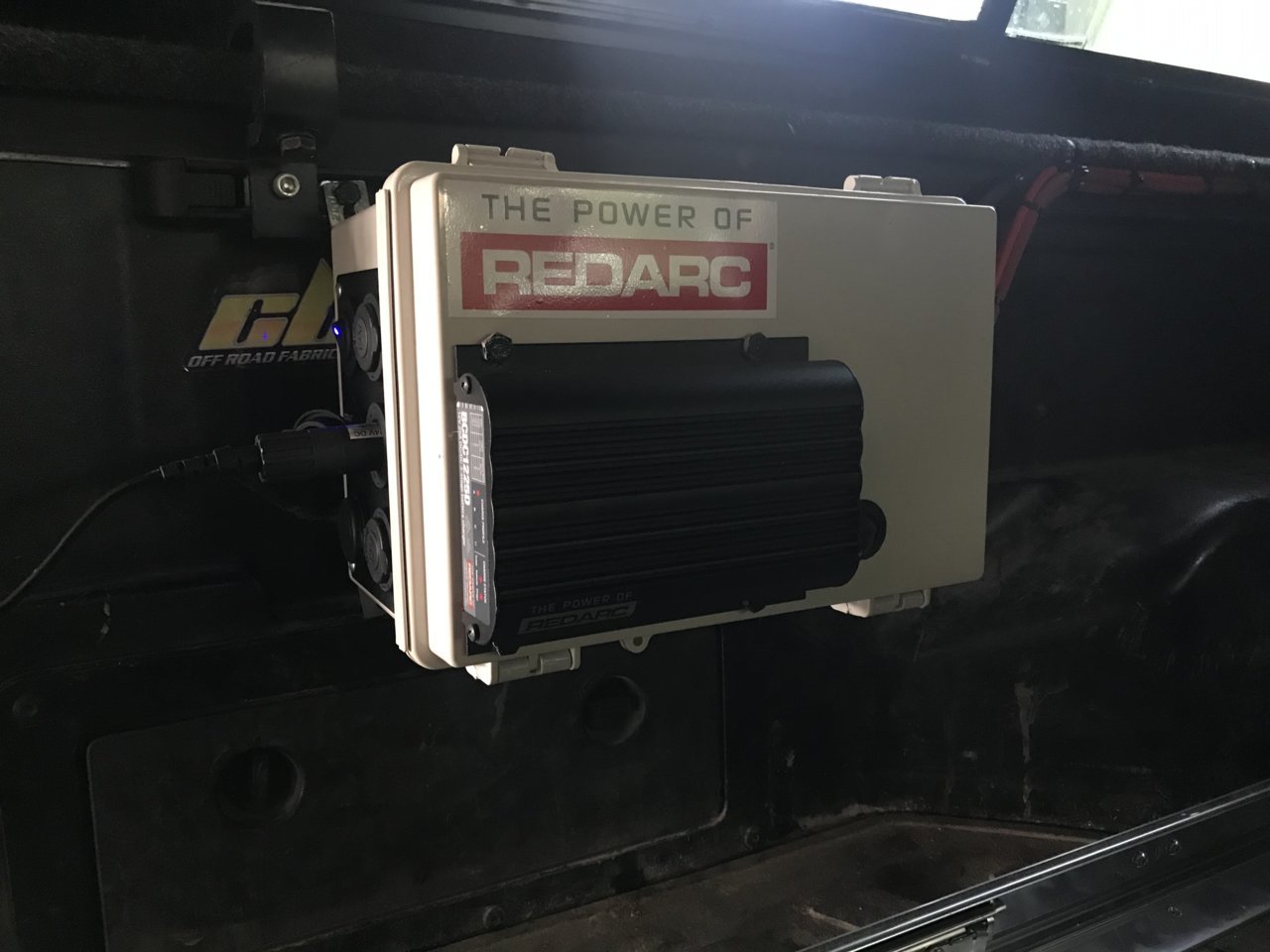

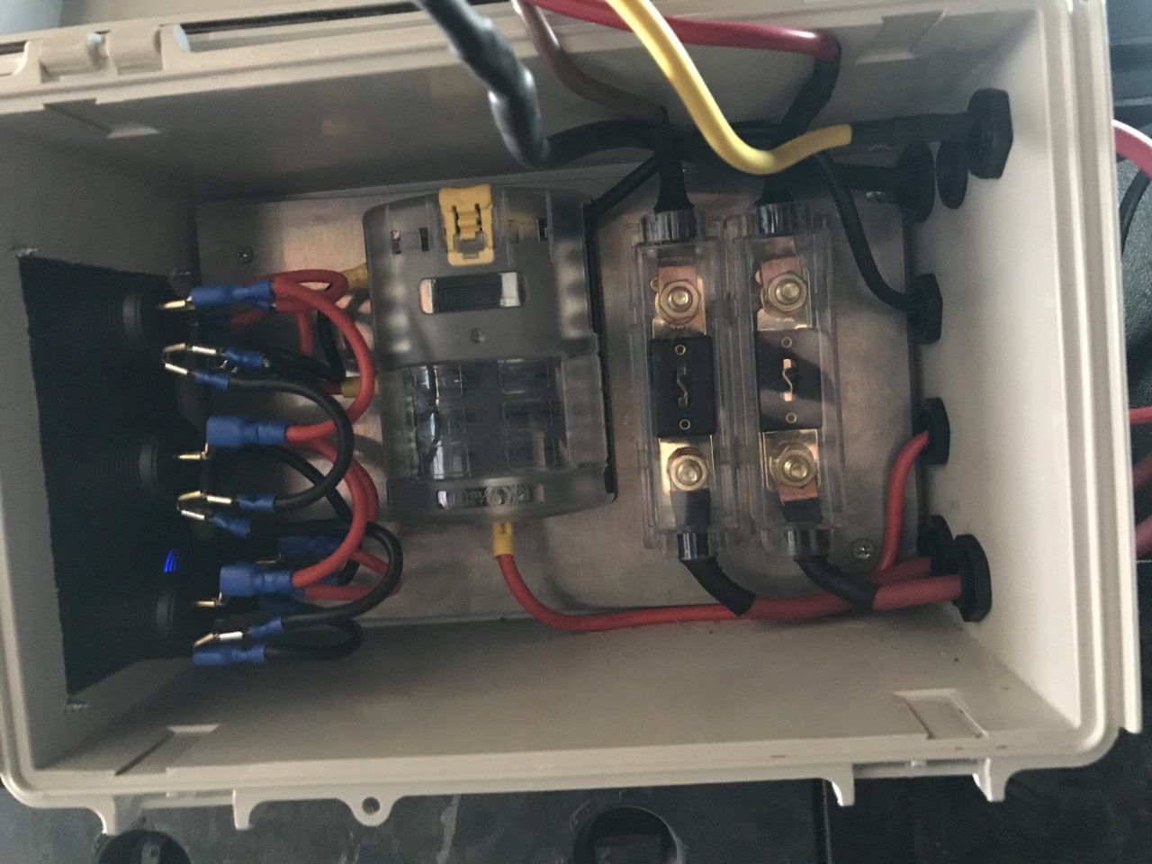

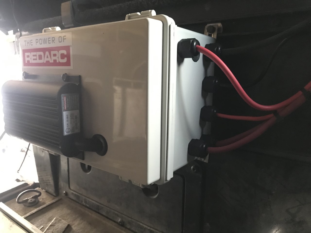

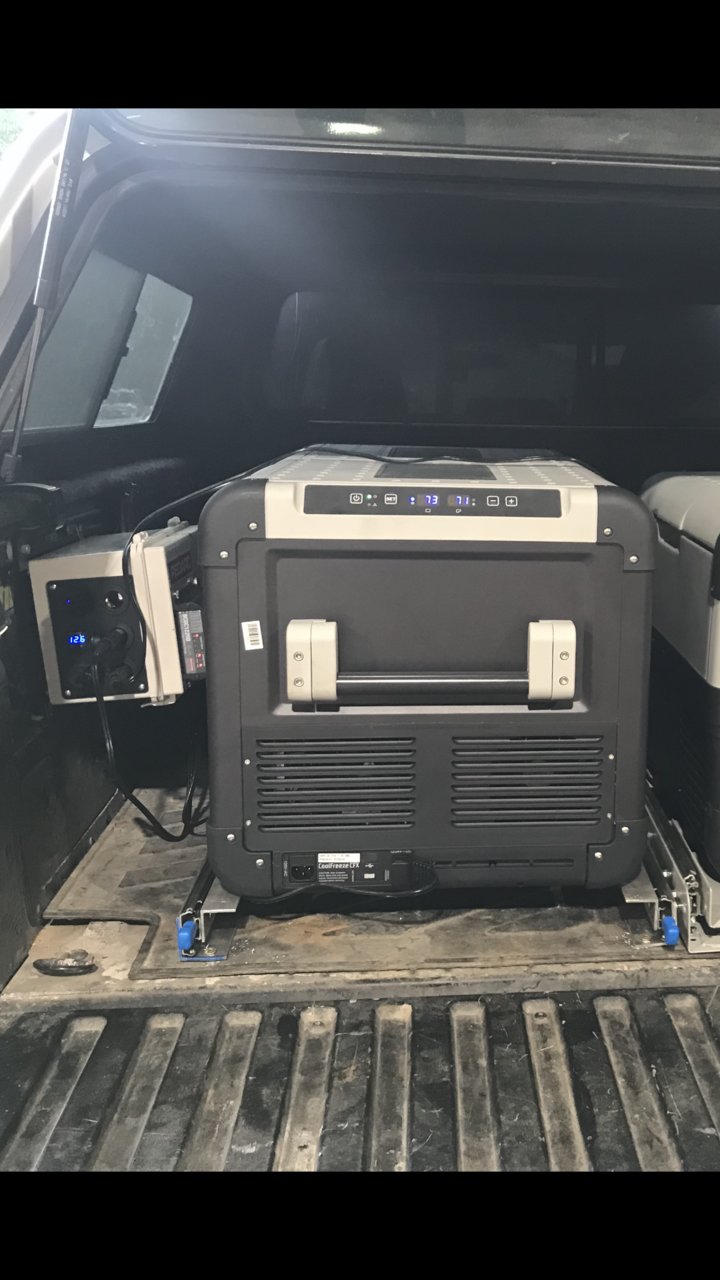

    I ran a 100ah deep cycle in the bed, power management by a Redarc BCDC1225D. Aux battery powers a blue seas fuse block, to a 12V power panel. 100W of Solar charges it during the day, and the truck charges it when it’s on. Solid set up for the value. My Dometic cfx75dz runs 24/7. I didn't want anything super fancy, so I pieced it all out myself and built it over a weekend. It works, I’m happy.

    71 and 73 degrees! Are you heating your beer?

    Haha, I had just plugged it in. I was actually running a cfx50 before I built my slide for the 75. It’s running at 34 and 02 now.

    Lol, I should have went with the 50 as a long term fridge. The 75dz is huge, and it’s power hungry. It hits voltage cutoff in about 48hrs. I’ve actually considered adding a 3rd battery :anonymous:. Interested to hear how the PLB40 works for you, seems like a solid option!

    Thanks, i’ll get you some pictures here in a bit

  17. Jul 3, 2019 at 8:21 AM

    I must know more about this set up. Part #'s? This is pretty sweet, looks really clean too. Good job!

    No problem, I purchased everything on Amazon so if you have a question I can link you to the item directly. The Redarc BCDC chargers are amazing, a little pricy up front but it’s a great standalone unit that has nothing but great reviews.
