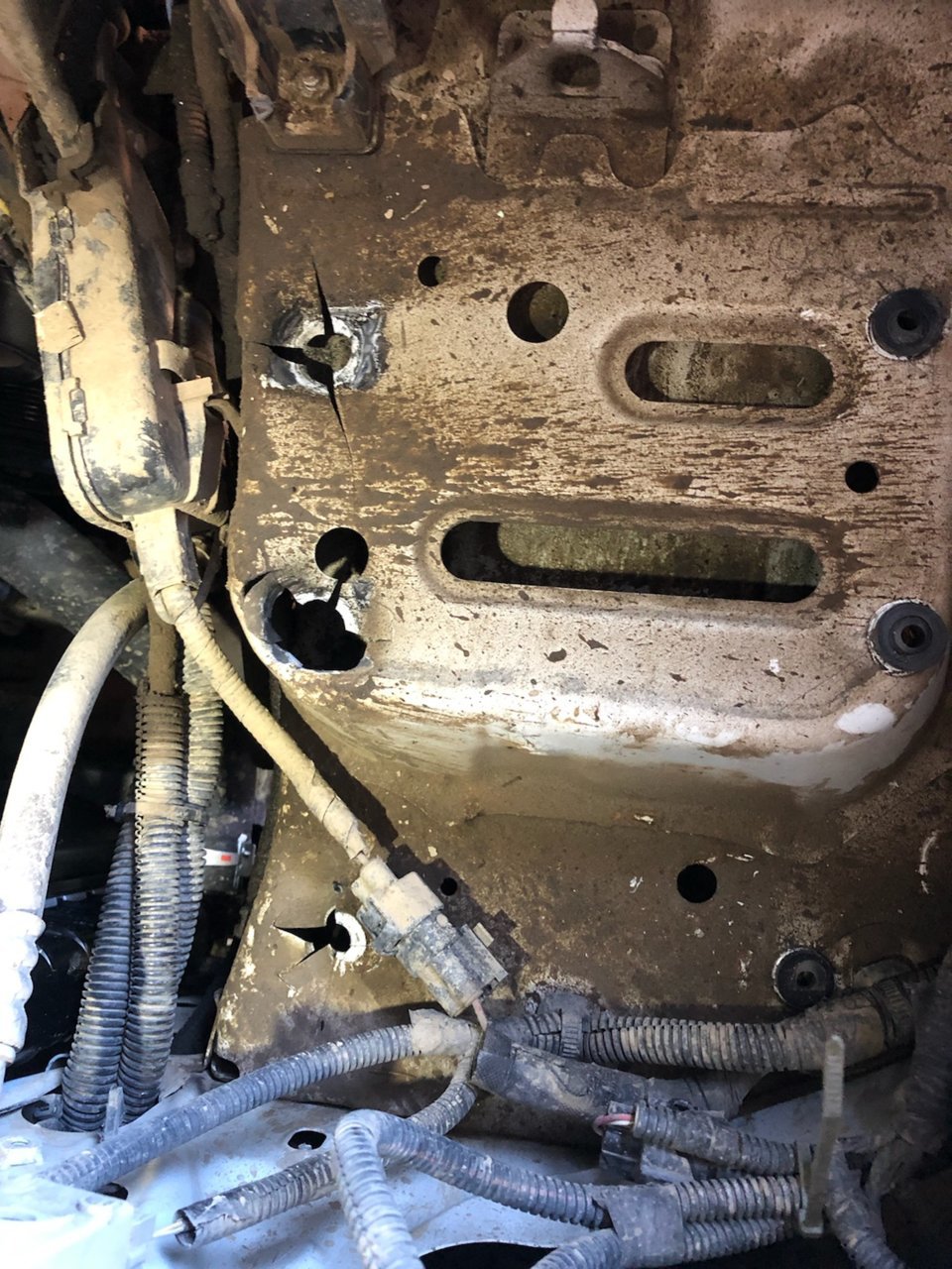

    There is over 100lbs of battery weight constantly torquing on the factory sheet metal where the Genesis 6 nutsert locations are. I have seen these locations crack. Maybe this is a rare case. This truck is not used lightly.
    b3itz and Skydvrr[QUOTED] like this.

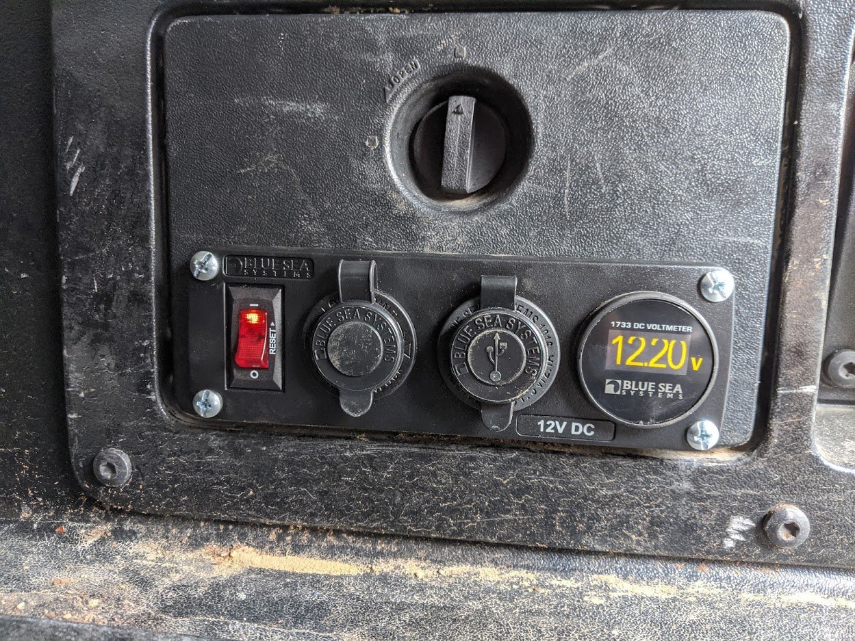

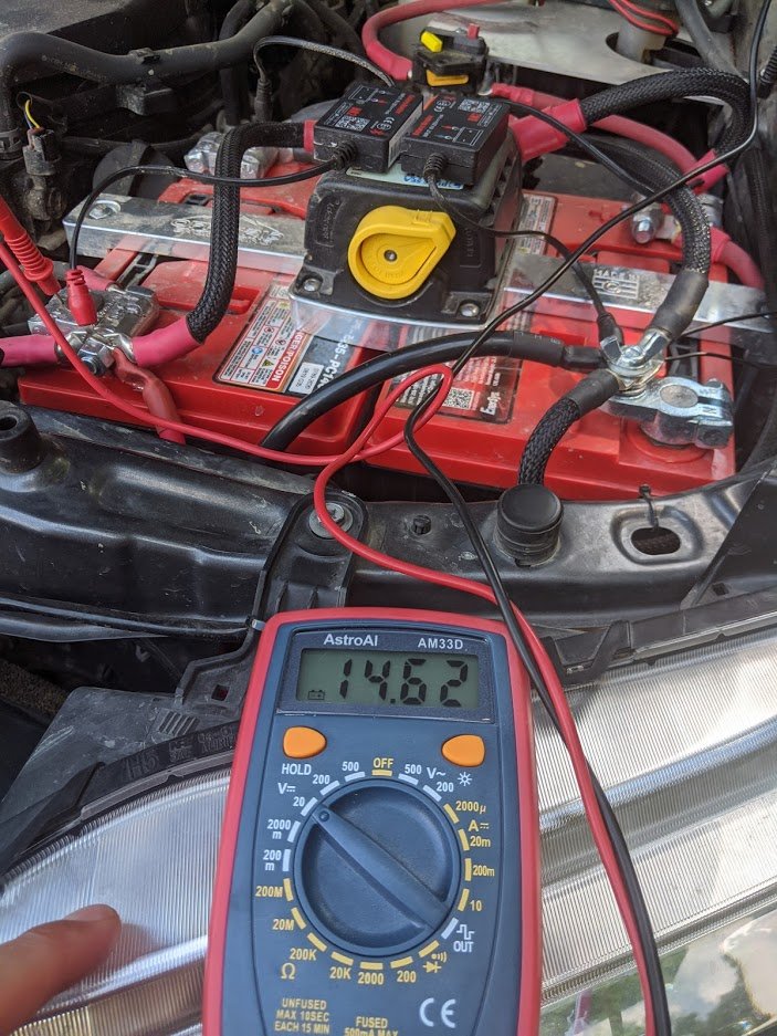

    FWIW, i did the OGE side-by-side with 2x Odyssey G35's PC-1400.
    I've also used VF to up the alternator voltage to what Odyssey recommended at 14.7v.
    I don't use them all that hard, but they've been super solid running heated blankets at night. I'm very happy....
    cmUaT3EdoDvvo-9AC8FasICusZj9xyNJsjC_Yb0H_ed778df0629bbd88763a57df7f922e447be7e6fd.jpg
    EEWVQcoz2R3FNdTc8onI5aqj9rMHgehfxCW-VxaU_7b00e96f7bc6a166d062137ba8358e4fc9107d32.jpg
    Looking back on things, i should have done a primary lead acid and a secondary AGM and charged the AGM with a DC-DC charger. Live and learn! As long as i get like 8-10 years out of the batteries, i'm happy
