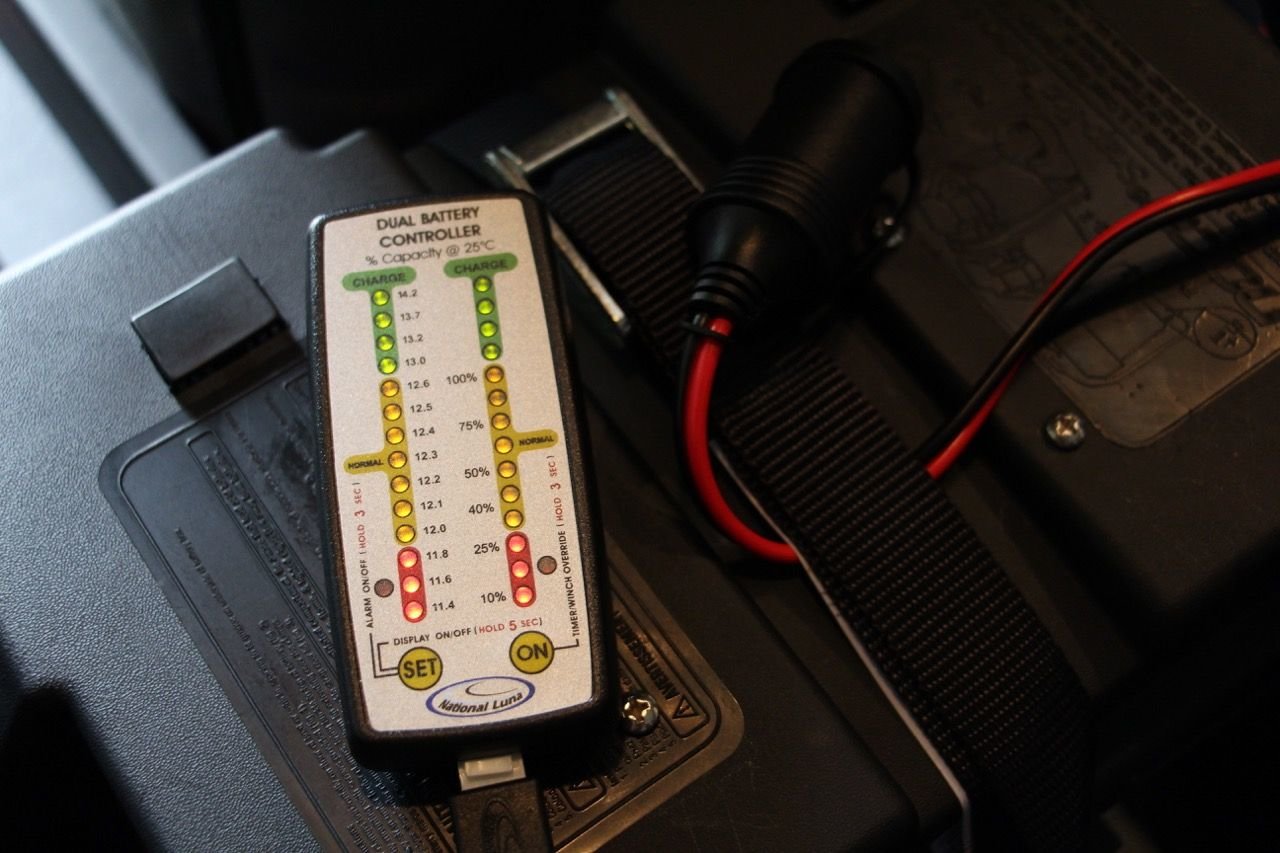

    Someone may have already discussed this in this thread, but does anyone know if these Tacoma specific options (Genesis or Off-Grid) draw on the main battery while the vehicle sits?
    I have the National Luna split charger in a Jeep TJ, which the Jeep sits more than not, and the National Luna solenoid draws on the main battery even with the controller below is turned off. Therefore when the National Luna is connected, I usually keep a trickle charger on the main battery if the Jeep sits for more than two weeks.

    YOTA 4X4
    YOTA 4X4 [OP] Well-Known Member
    Jan 29, 2018
    #242780
    2,594
    2017 Double Cab Off-Road
    OME HD Lift all around, SCS SR8 Rims, 255 85 R16 Cooper ST Maxx, Decked Drawers, 30" Rigid Pro Light bar above bumper on Rago Mounts, Rigid Dually Side Shooters on Rago ditch brackets, Hondo Garage Un-Holey Phone Mount X2, Hondo Radio Knobs AR Bolt Face, Garmin InReach SE GPS synch'ed to Iphone for GPS only mapping, Wet Okole Seat Covers, Husky Liner Contour floor mats, 63 QT ARB Fridge on Alu-Cab tilting slide. GoFastCamper (#41), ARB 2500 Awning with Full Room, Mobtown Off-road Sliders and Full Aluminum Skids.
    No they have isolators.

    grogie
    grogie Sir Loin of Beef
    Nov 4, 2019
    #309846
    876
    2019 TRD OR AC, 2018 4R Limited, 2006 Jeep TJ
    Genesis does say: "Smart Isolator automatically handles all charging functions..."
    Off-Grid: "...isolate your auxiliary battery from your drivers seat"
    yep, isolators.... what’s your question? Isn’t that what you asked?

    876
    I misread your answer... Thanks for the clarification.
    My original question was if either of these two options draw power from the main battery while the vehicle is turned off? The National Luna's solenoid that I have in a Jeep does, enough that it's an issue if the vehicle sits for several weeks. Thanks.

    #309846
    876
    To answer my own question, I found this that the Blue Sea does draw power when in standby:
    (Scroll to bottom to see chart)
    https://expeditionportal.com/dual_battery_systems_for_overlanding/
