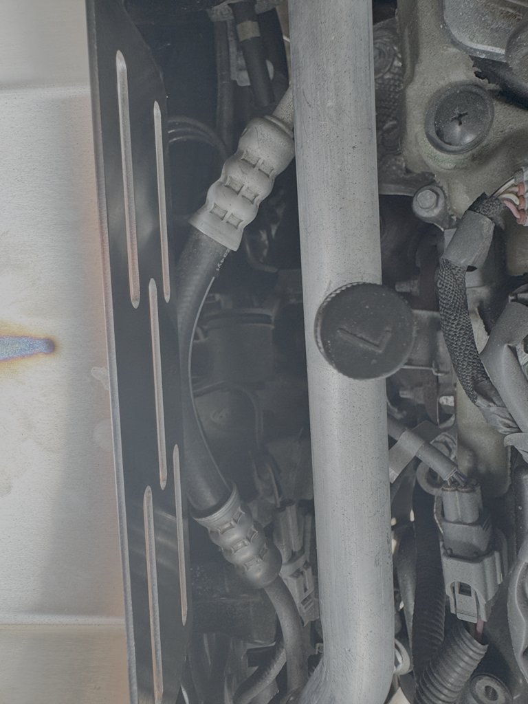

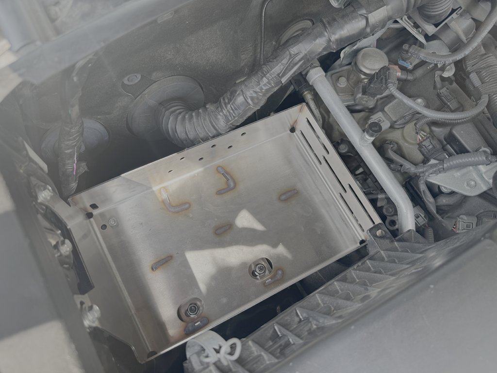

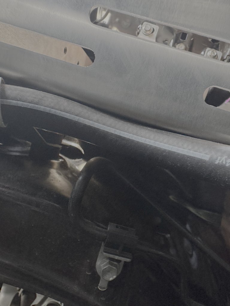

    Sounds like I may just go AGM but a related problem:
    I purchased the Rago Fabrications battery tray but due to the orientation of the lower AC line that goes into the fire wall, that hose rubs on the battery box. Given the angle of the weld sections of that tube, there is next to no movement and I can't get it out of the way.
    I contacted Rago and they said it will eventually rub through and cause a problem so advised I wrap it with something to prevent abrasion. Problem is, there is already a fair amount of downward pressure on that line since it can't flex and wrapping it will only add thickness increasing that problem. I'm not sure if a different battery box wouldn't have the same problem given the location of that section of AC hose.
    Anyone else run into this? What did you do?

    If I'm seeing the angle of it right, would you be able to raise the box slightly by putting a few washers under the box brackets where it's bolted down at the bottom?
    Usually it also is possible to bend the metal tube portions slightly on those lines, though this does carry a small risk of damaging it if you're not careful.
    Failing all those, a couple wraps of Gorilla tape on the rubber hose should prevent a smooth metal surface (box) from abrading through the hose.
    scaley[OP] likes this.

    Yeah I tried that but there isn’t enough thread engagement on the studs after lifting it to where it needs to be. There are F-F cylindrical nuts that would allow me to raise it enough and then bolt into the new threaded stud, but I didn’t want to try that route just yet since it requires drilling new holes in the side supports (easy) and thus making this not returnable it doesn’t work out.
    I did swing by an AC automotive shops and they definitely didn’t like the pressure on that fixed line and hose that goes into the firewall. I might just return the case and do a custom fabrication solution.

    Yeah probably best to return it then.
    Rago apparently needs to redesign their box if that A/C line is factory in it's factory position (have the box up a little higher, provided it doesn't create a clearance issue with the hood).
