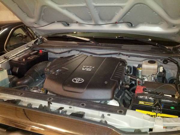

    I like how your system is weight balanced. I was thinking putting one in the truck bed on the passenger side. But if there is room under the hood, I would prefer it there.

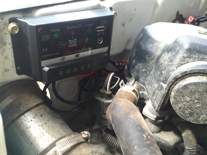

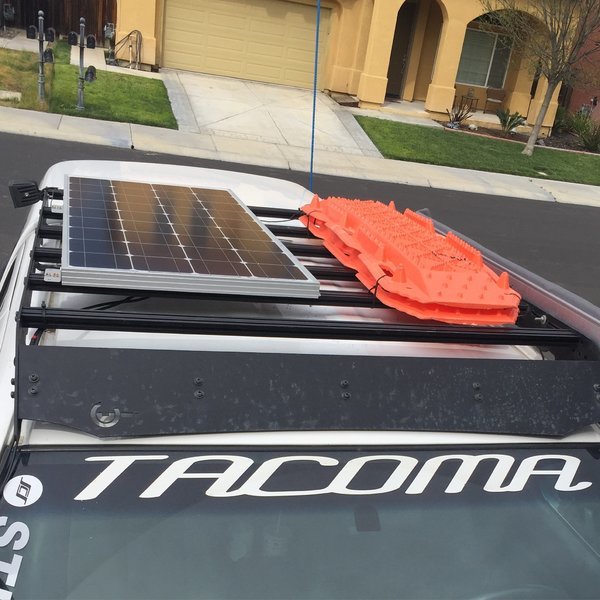

    Well I fixed my power issues over the weekend with some help from Mj.
    Solar
    Dual batteries
    2000tacobro and docloco like this.

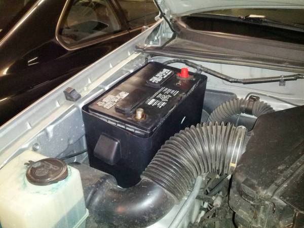

    I would say the key is to distribute the weight as evenly as possible when installing the battery over the inside fender. I have four points on mine with fender washers at one end; a thick mending brace down the middle (with two mounting points on the fender); and a thick L bracket at the front end, bolted off the fender. That being said, I have yet to install the battery and carry the weight around, but I was cognizant of the weight on the fender when I installed the battery tray, a metal WirthCo model.
    If you do go with batteries in the bed, definitely consider going with solenoid relays over diode, unless you get the $300+ models. Diode relays will take about .5 volts off your system; add up voltage lost over long wire lines and you'll be looking at long alt-battery charge times.

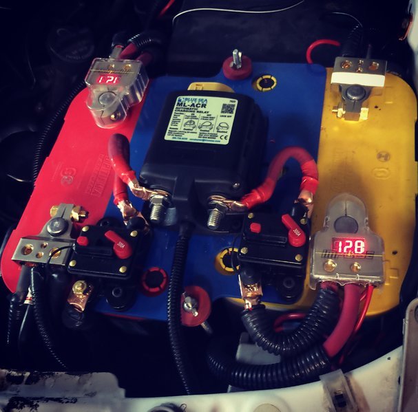

    I have a couple of question for those that have installed a Peak DBI voltage monitor with a Bluesea ML-ACR. Where did you connect the red and yellow wires on your setup? Did you go all the way to the positive post of the respective batteries? Or perhaps to the posts on the ML-ACR?
    If I connect to the ML-ACR, do you think there will there be a significant voltage drop? Significant enough to not want to do it?

    I connected mine to the two terminals on the ML-ACR. They were easily accessible rather than running wires to my fuse panels or battery terminals.
    I don't see a voltage drop. We are running 1/0 cable to the ML-ACR so it's probably insignificant

    The ML-ACR is a smart solenoid relay; that coupled with the large 1/0 cables, and you got yourself a solid system. Comparatively speaking, 10 ft of 2AWG results in about .40 voltage drop; 1/0 is about .25 drop.

    Thanks for putting some numbers to it. I just knew that I wanted as much efficiency out of my system as I could get and 1/0 was one of the cheaper ways to achieve that.
    @Digiratus based on the website that Chuy copied, for the 50ma draw of the monitor it looks like the drop is around 0.001v with 1/0 to the ACR terminals. That monitor isn't that sensitive anyway with LEDs about every 0.3 or 0.4 volts. Its got to be better to run 4ish ft of 22ga(?) from the monitor to the ACR rather than run smaller gauge wire all the way to the batteries (one of mine is behind the rear seat in a DC). If your batteries are closer to the monitor it might not make as much/any difference

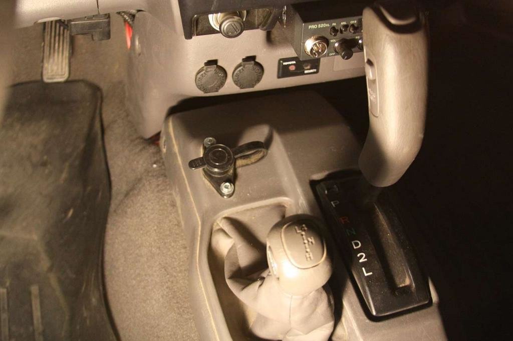

    I really appreciate the feedback but my '02 is quite a bit different so this part is interesting but probably not that applicable to my situation.
    I'm actually thinking about placing it next to the winch plug on the center console.
