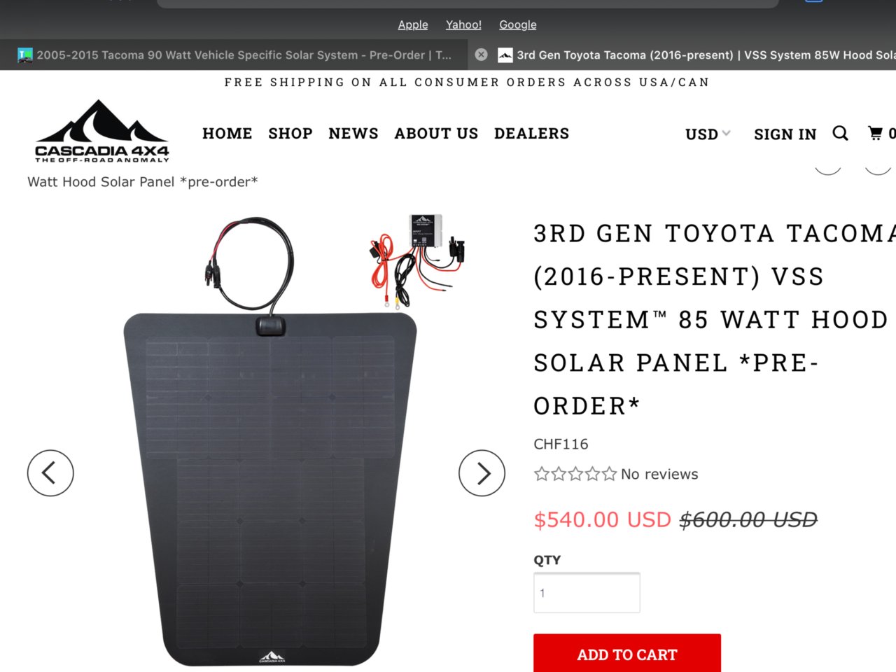

    Have you seen this hood mounted panel?1CCDABAC-27FE-45D3-ACE3-B8124A032993.jpg

    There was a shitshow of a thread about it awhile back. Neat idea, efficient use of space, but very high cost for the package setup. Very much like buying Goal Zero versus build your own. Convenience comes at a cost. I would probably use my hood but the skewp nullifies that idea.

    Its definitely an interesting idea. I'm not sure I'd like the look on a cement truck... maybe if the truck was black.
