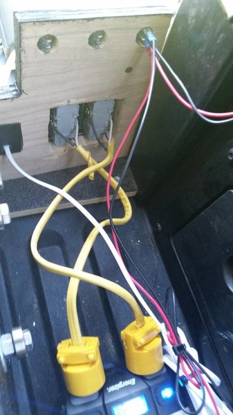

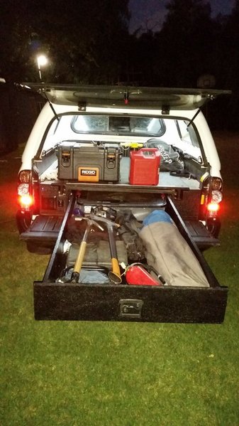

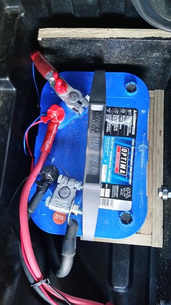

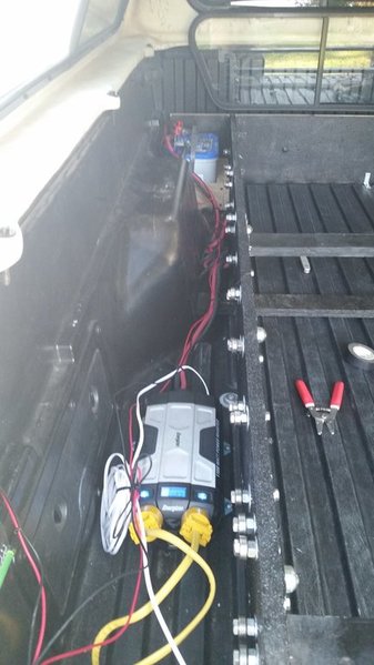

    Here you go...
    I put my aux battery in the bed because I had some extra space next to my drawer/under my bed slide.
    That's down the side of the bed obviously.
    Opposite side of the inverter from pic 1
    Battery pic - My terminals match now. ;)
    The outside view. You can see the 110 outlets on the left next to the on/off switch for the inverter
    I don't have any pics under the hood (it's sloppy under there right now haha) or of the controller just yet, but like I said I have an IBS DBS. Where my toolbox/gas can are sitting slides out the full length of the bed as well for easy backloading. Things get cramped under that shell.

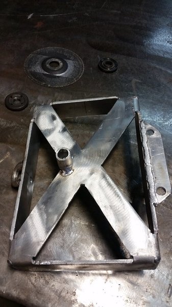

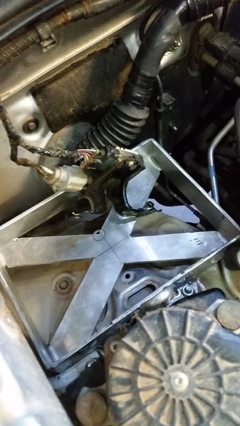

    One of my own design, simple but effective 20150608_192614.jpg 20150608_193415.jpg

    Just the small module that mounts on the firewall, took it off its bracket and zip tied it to a secure spot. The location is perfect size, u can see the module in the engine bay pic above the optima

    Lol i would, but i dont work at the fab shop anymore. Gt me one of those easy money jobs haha. There are 2 bolts already there, not too much imagination and i bet ud figure out a better way than me. Hell, a 6x2 with some holes would work excellent lol
