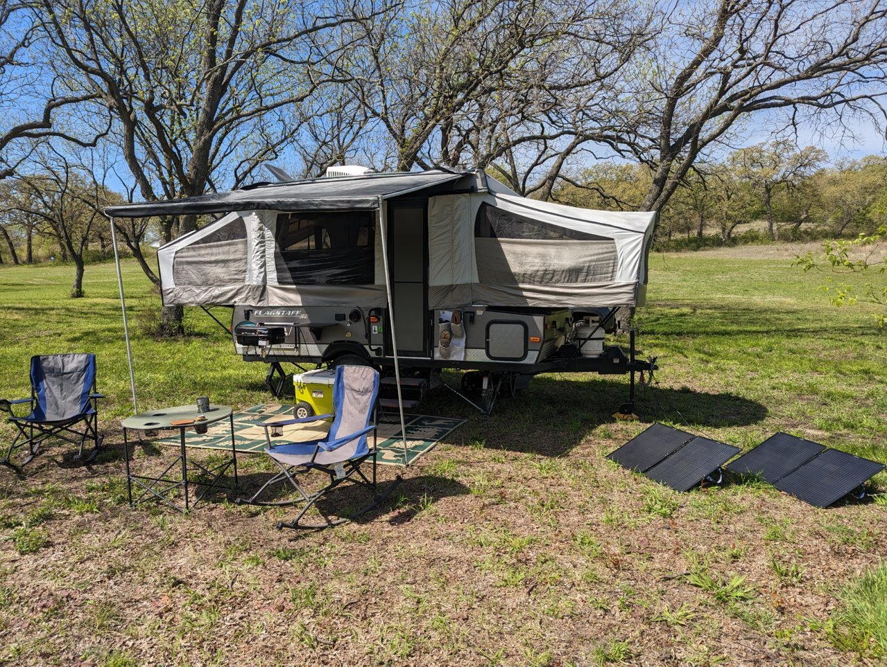

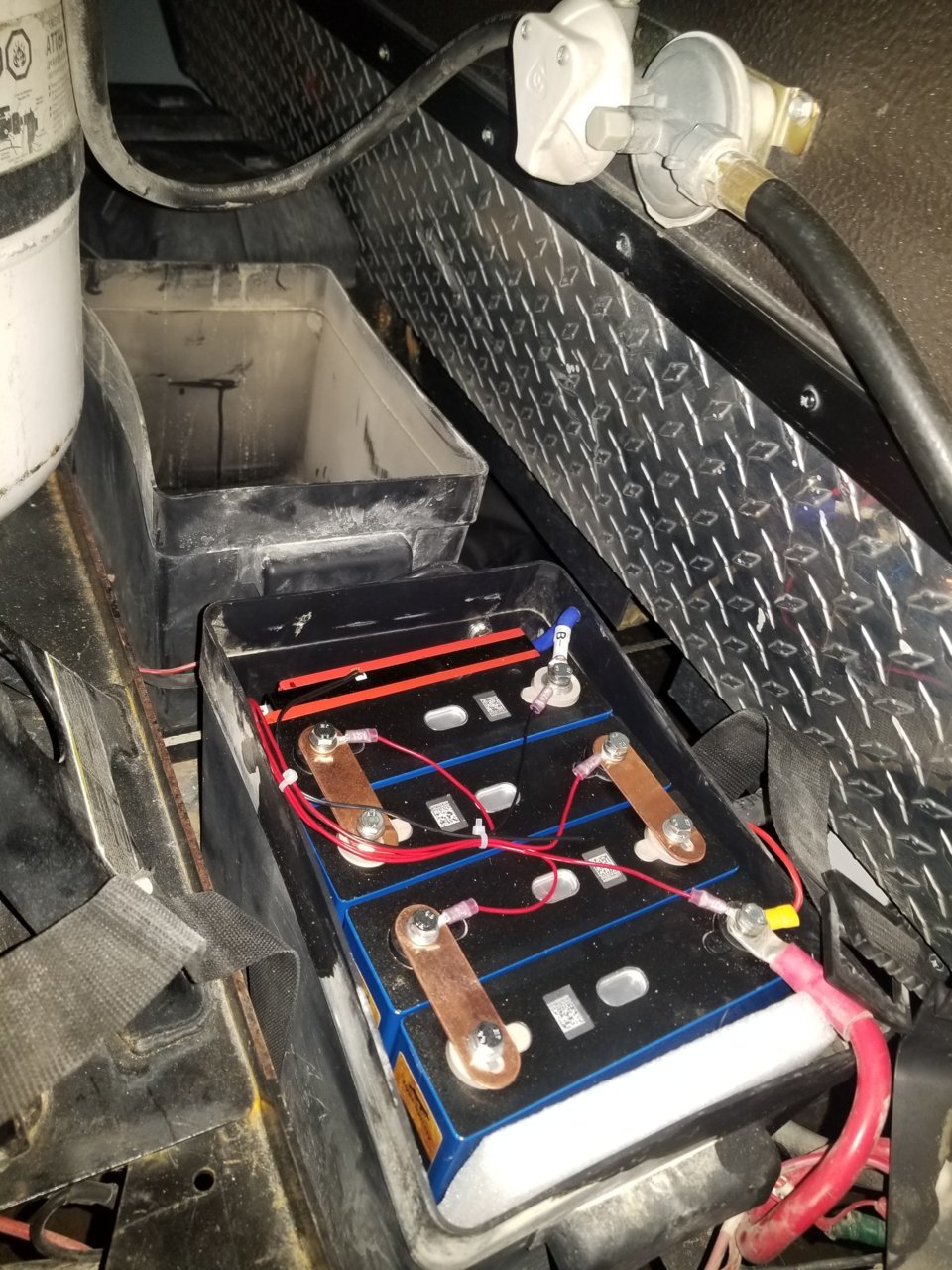

    Start by calculating your draw, both peak and average. You want a minimum 3 days worth of electricity in the bank. Because sometimes clouds exist, and it's nice to go an entire weekend without having to break out the solar. This is where a home built box takes advantage over a power station: my 120 Ah battery fits in a group 24 box. (Same capacity as a Jackery 1500) It's a little cheaper and a little more compact if you build it out.
    However, the disadvantage is that my battery needs to be wired to a fuse block, battery monitor, BMS, charge controller, inverter(optional), and appliance outlets, all of which would have been integrated into a power station. It's easy for me since I used most of the existing infrastructure in my trailer. For truck campers, it's up to you whether you want to go the easy way or the fully involved way. If you home build it, it's involved.
    For solar, you want to be able to recharge 2 days worth of consumption in 5 hours off peak sun. Again, clouds and trees exist. If a birds shadow is within a 2 mile vicinity of your panels, expect to see about half of your generating power.
    I'm a big fan of these. Eco worthy 100W hard panels, but they fold and have their own adjustable kickstands. Perfect for deploying and catching a few hours of juice. When they're done they stow easily.
    But once you know your consumption, then it will help guide which route you want to go.
