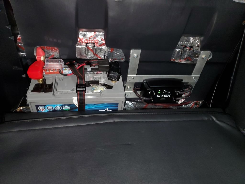

    I'm sporting a dual battery set up with Ctek D250se DCDC charger and a solar panel. After over thinking the hell out of it, this whole thing was built to power a 75 qt fridge.

    Thus far it was only used for the fridge. Winch and off road lights are powered from main battery.
    I'm thinking of connecting CB and GMRS radios to aux battery, as well as whatever camping/convenience Lights If my build will get that far. We'll see.
    So far "No ragrets"!! As of changes, this whole thing is still a work in progress , so changes are possible as work progresses.
    Now, I bought Ctek instead of RedArc 1225 due to availability and also because a) I've seen someone else making it work the way I wanted it, and b) because of wrong schematics I've seen on interwebs regarding connecting a solar panel. I was wrong about it, as it connects the same way.

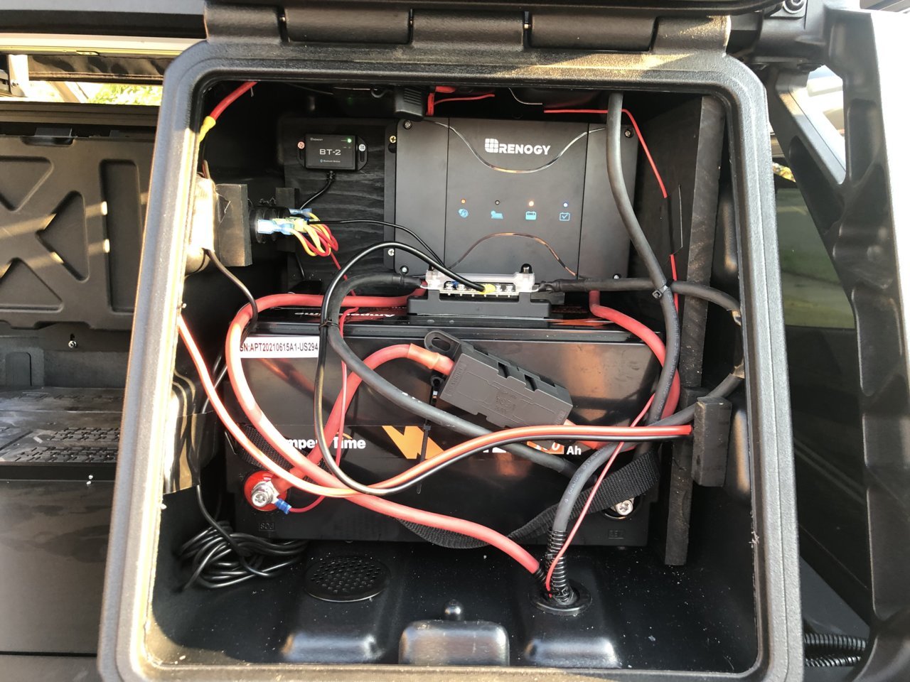

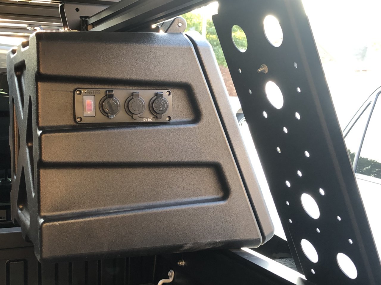

    Used a Leitner Designs Gear Pod
    100AH LiFePo4 battery
    50A Renogy DC charger/MPPT controller
    Blue Sea DC panel

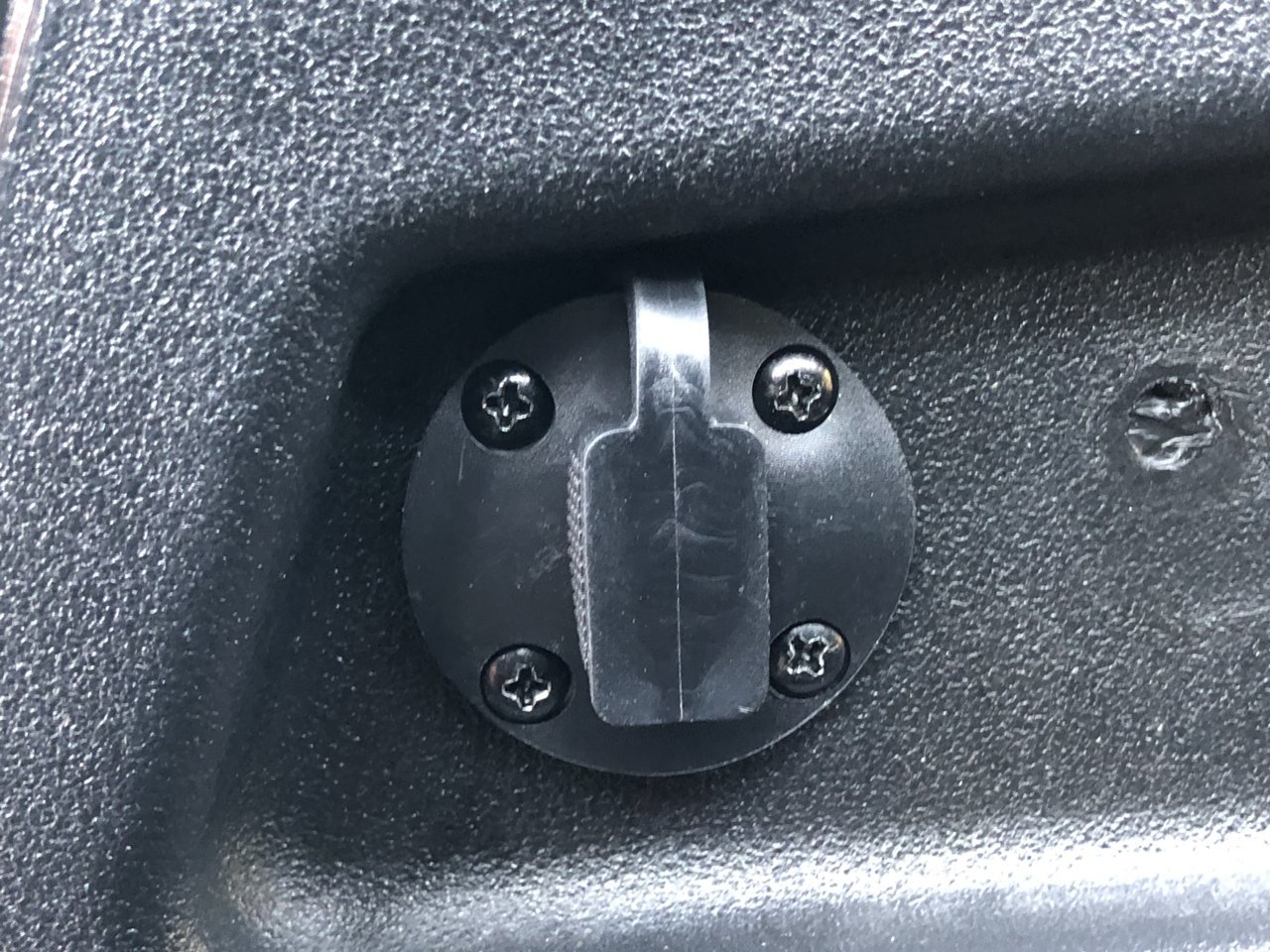

    SAE port for solar input

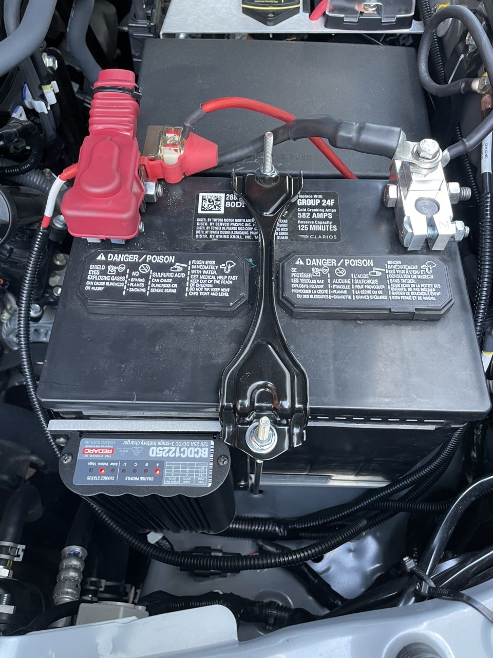

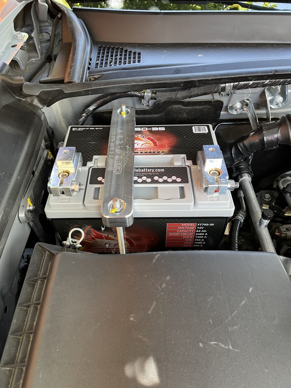

    Mine is:
    Stock ship's battery. Truck is less than a year old, so that will eventually be replaced with something beefier.
    Overland Equipped aux bus with Blue Sea fuse block.
    Off Grid Engineering ship's and aux battery mounts, Full Throttle group 35 aux battery and Redarc BCDC1225D MPPT controller.
    Cascadia 4x4 85W hood solar panel. Not installed yet -- been waiting for the weather to cooperate and line up with having a couple of friends help out. My use case is just to have it keep ship and house batteries topped off -- not really to power things continuously.
    Pics are early stuff from the install. It's all functional now.

    how’s your set up going? I was actually thinking of this same set up to have a charging station for my drone and cameras.
    From my research the Leitner GearBox is not waterproof.

    Sorry to bring this back to life... Do you have any more pics of how you mounted the DC-DC charger to the side of the battery like that? Thanks!
