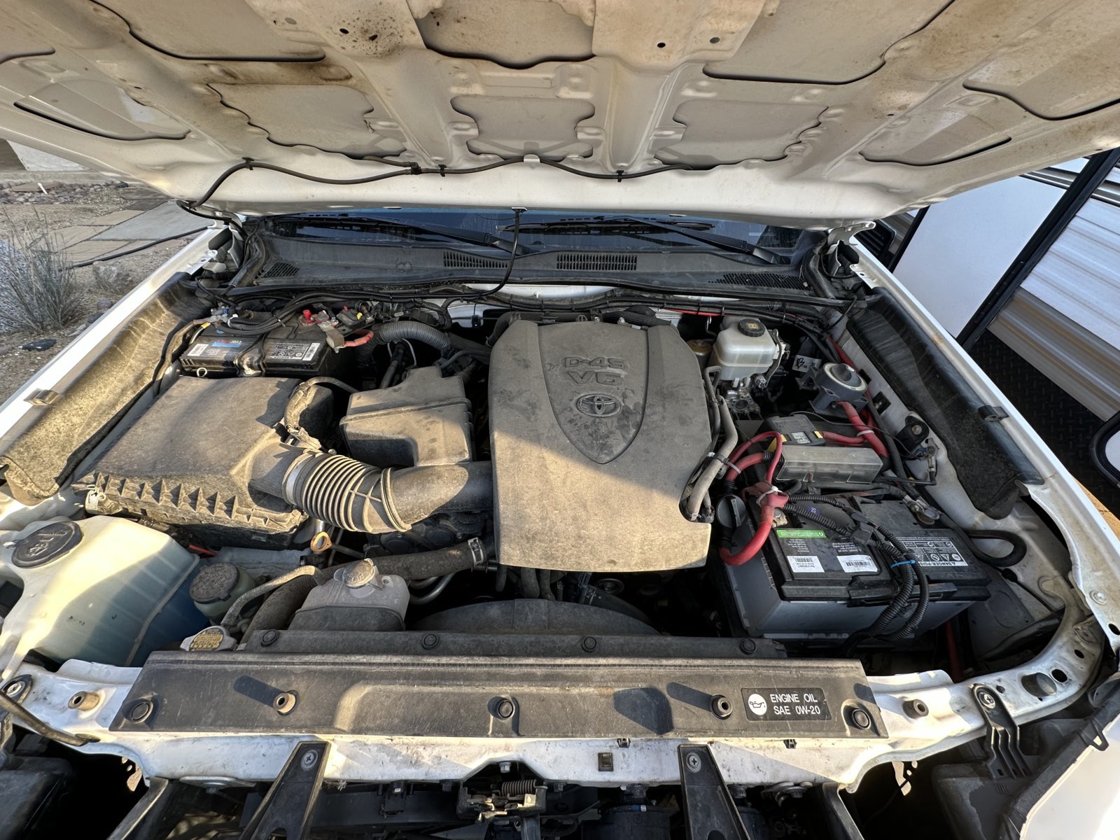

    Here is a little of what I have going on…IMG_1236.jpgandIMG_1237.jpgi have cascadia 4x4 solar panel on the hood, single arb compressor under the passenger seat, warn winch, constant wiring to the cigarette lighter in the cab, and in the bed for a fridge. Oh and a Bunch of leds from vleds, 30” light bar, 2 6” light bars. But I really got the batteries and panel after I got a fridge.

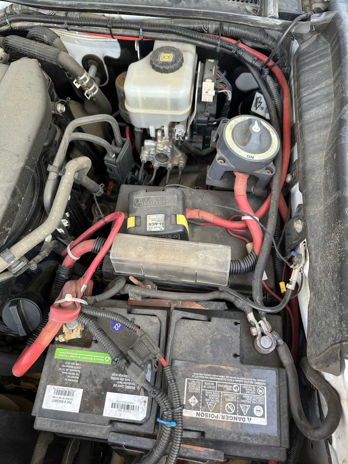

    Why are the two RED cables descending into the engine compartment where they are?

    Goes to the charge controller.

    It’s a kit from sdhq, it fits in there pretty nice. Not cheap though.

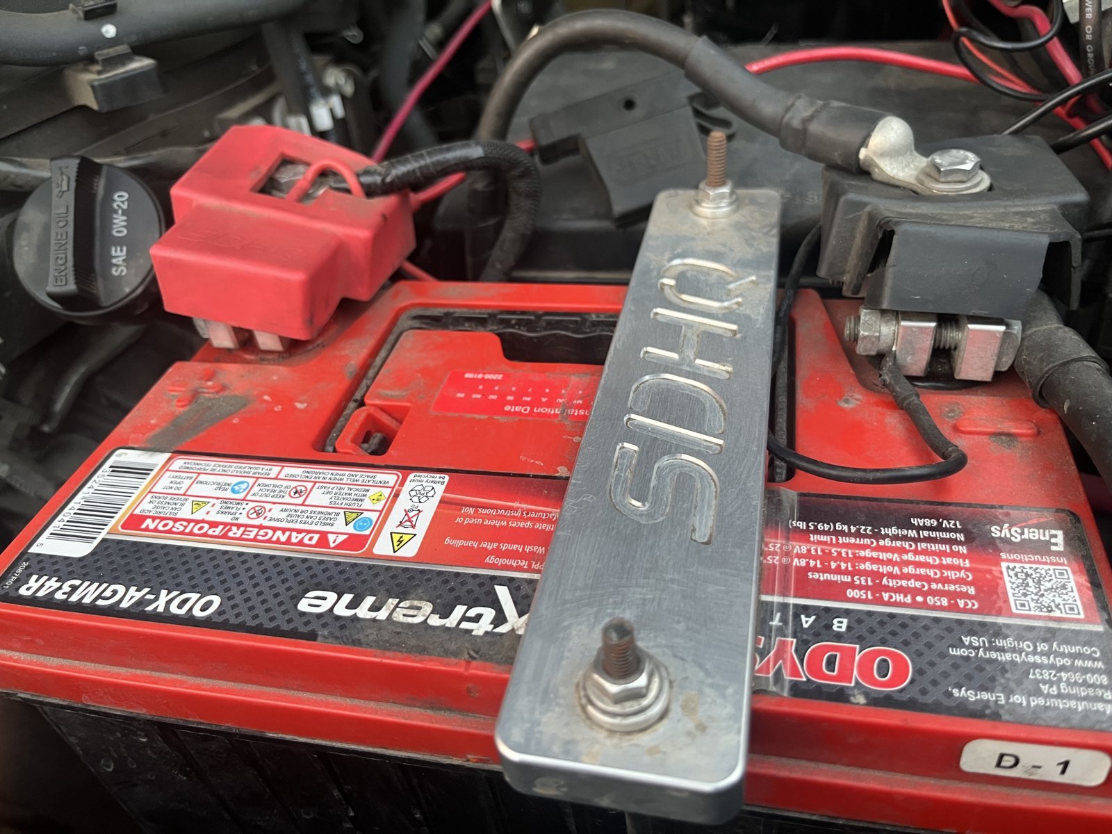

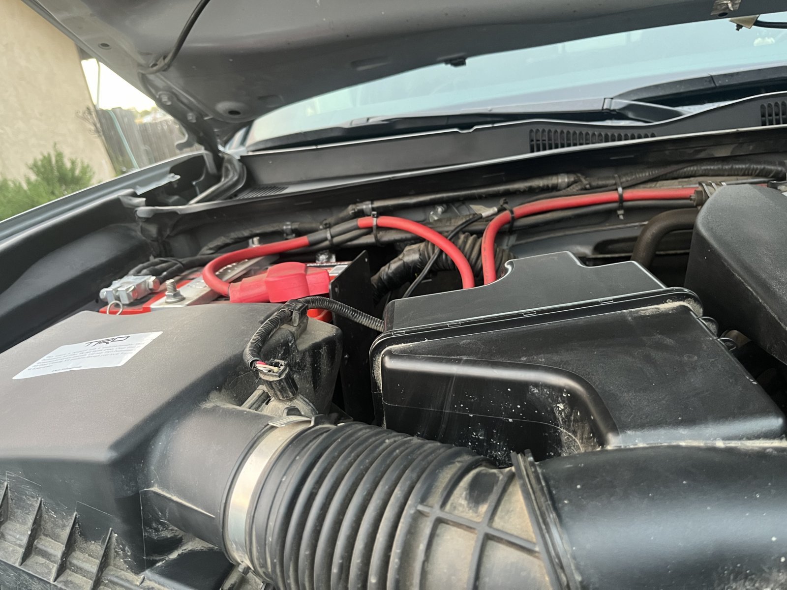

    So they put the charge controller down below? Oh! I put mine next to the main battery- sorry, I just assumed yours was in the same location.
    As for neatness, I shouldn’t talk. I made a custom battery mount for the auxiliary battery using angle iron, and built my own cables for it. I have a couple extra fuses on that battery, one for the charger (red one) and the other is a switchable relay for the line running to the back of the truck for my refrigerator, and one also to my solar charger. I have a Cascadia solar panel on the hood and one in back so there’s a switch for that, and I have an auxiliary switch on the driver side for a winch set up. the battery charging relay/controller is right next to the winch switch on the driver side on top of the fuse box, and that’s a high amperage fuse in the long rectangular case for the winch.
    ** And upon opening my hood to take these photos, I noticed that there was a small cat or something (based on those prints) that was running around the top of my engine - so glad I didn’t find chewed wires!!

    That was weird until I looked at the install instructions which show some pictures - the charge controller is mounted to the driver's side of the added battery, thus the cables.
    50-3002-U1_Install_Instructions.pdf (shopify.com)
