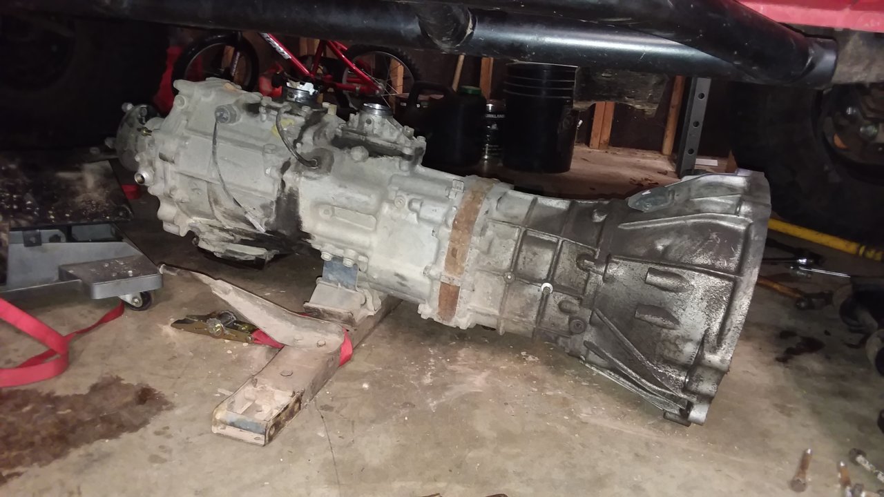

    This fell out tonight

    You didn't have to drop all that for the crawl box

    I do for a new clutch and rear main seal!
