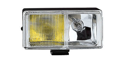

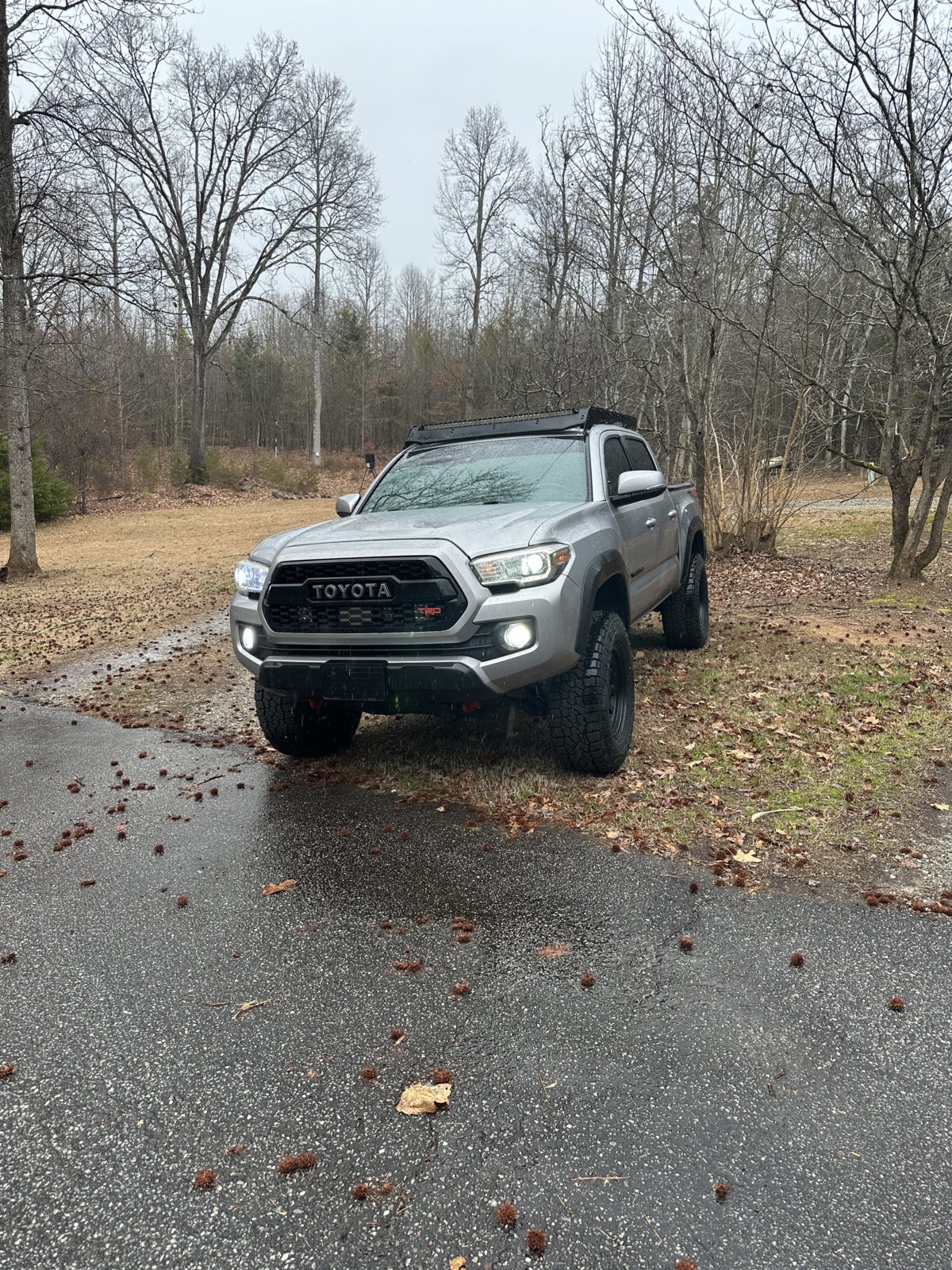

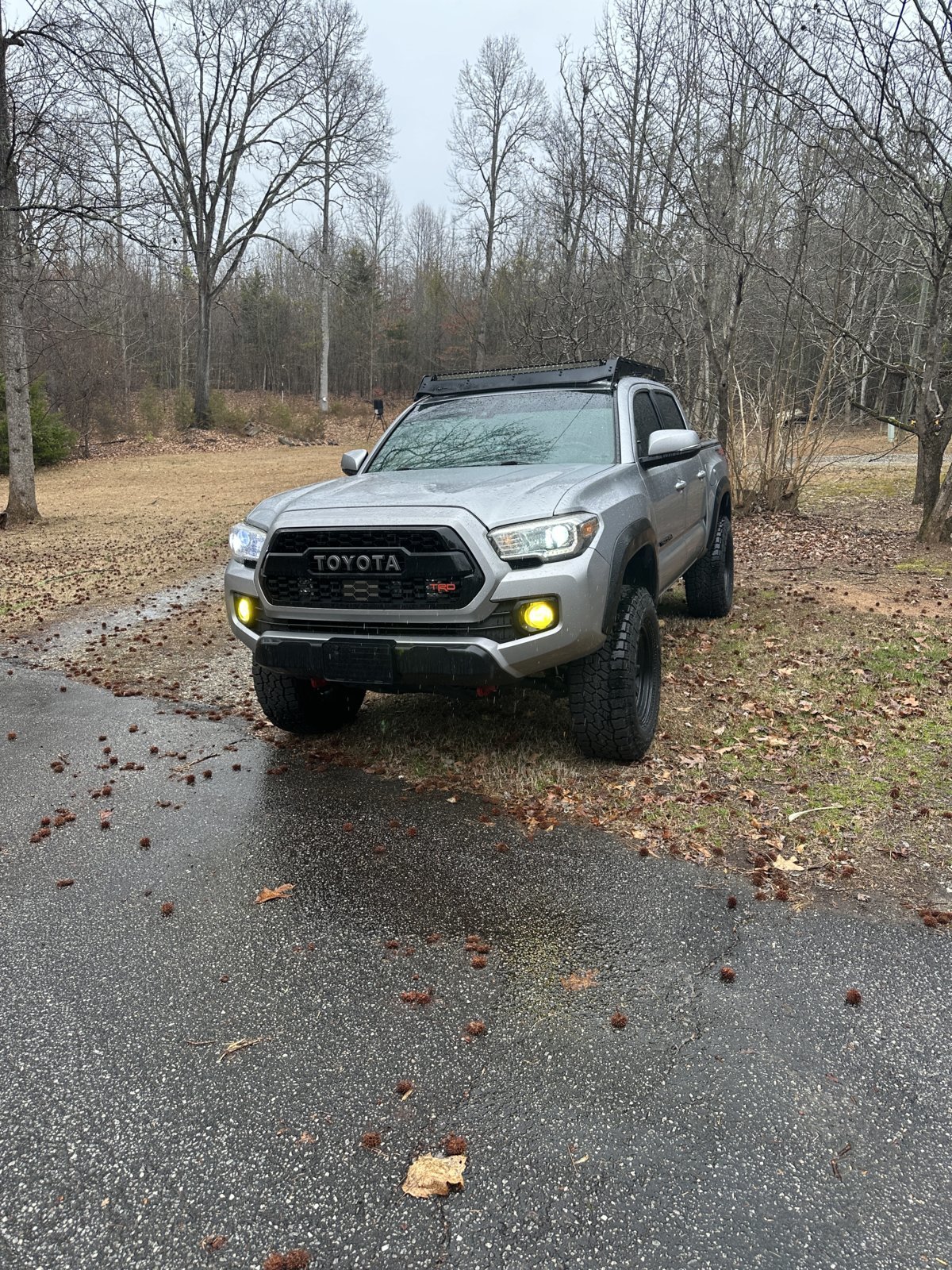

    Here are a few photo. Mind you, it’s daylight and rainy, the photos don’t do them justice. They look great and crisp IRL.
    No additional wiring. Simply turn them off and on to switch between the colors. They default to white.

    Also not a reputable company. Stole IP from Diode Dynamic, even blatant copied their website and changed the name. Got sued. Not a lighting company I would support.
    What you don’t see is that your beam pattern is trash and you are causing glare to oncoming drivers causing yourself to be a danger on the road and for your lights to be less effective in the conditions they are designed for.
    No reputable company makes dual color PnP LEDs because it is not technically possible for them to optically work correct in a halogen housing. So your left with cheap Chinese companies selling you snake oil.
    The one listed in my quote from the other member. I’m not going to repeat it to minimize use of their name.
    I’d highly recommend not following some of the very bad advice given here on multi-color PnP LEDs. All the vendors mentioned are those that have very bad reputations and should be avoided. Unfortunately lighting is complicated, many people turn a product on and see that it lights up and call it good. Forward vehicle lighting has much more to it than that about beam pattern, cut offs, intensity, is the light going where it is supposed to go in the pattern? For an LED to work semi-correctly in a halogen housing the emitters need to be where the halogen filament is located, precision is so important. Since you need 2 emitters for multicolor, they both cannot occupy the correct position, so they are both in the wrong position causing the output to be garbage. Yes it lights up but the pattern is all wrong and now you are a major hazard on the road to everyone else. I do lots of lighting product reviews and have reviewed multi-color PnP LEDs before, see post #29, these were done in a projector headlight where the projector cut off eliminates the glare, because everyone knows not to use such a poorly designed product in a reflector fog.

    I remember my buddy had those on his truck..long ass time back of course.

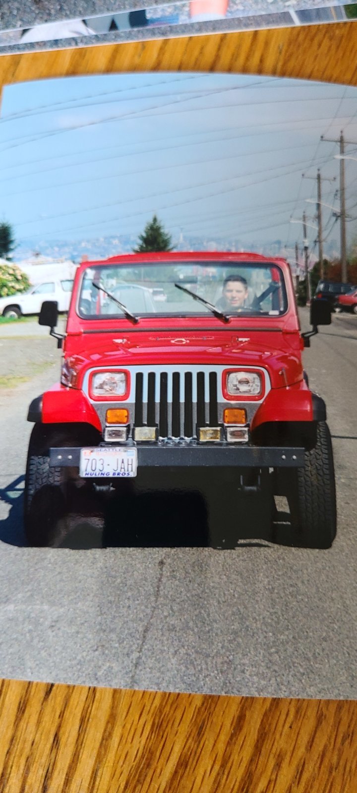

    Not the same dual lights... but back in the day...
