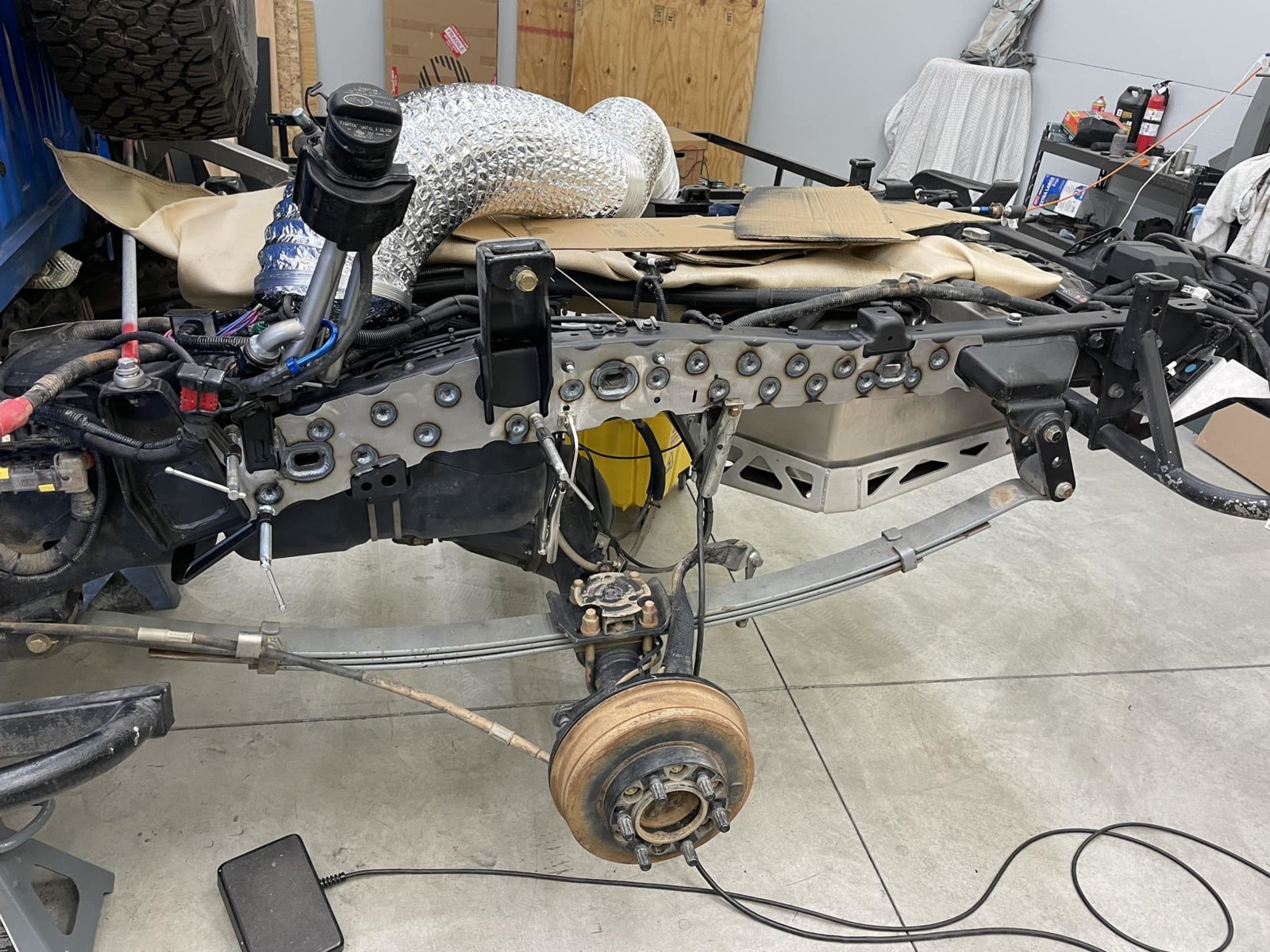

    I added a secondary 22 gallon tank behind the rear axle in addition to the stock tank
    been working flawlessly since install.
    Single fuel fill neck, it fills the main tank first, then will fill the aux tank.
    Evap has not noticed anything and haven't had any CEL/codes.
    Sorry this is the only pic i have at the moment, currently doing a bunch of other mods.
