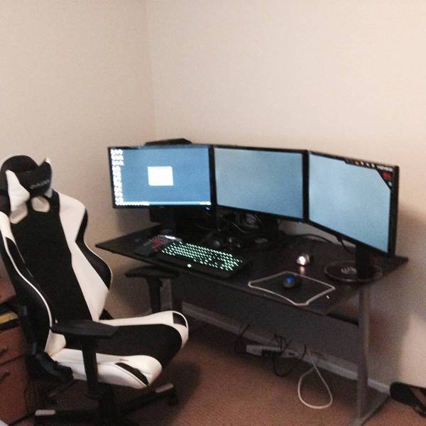

    Actually the 980 has 3 DisplayPorts to use. Use the display ports. No reason at all not to use the latest and greatest. My son is using all the DP on his triple screen setup.

    That's a cool chair!
