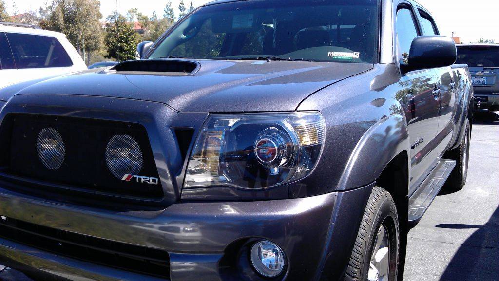

    That's not mine... My new Depo housings remain unopened, retro kit showed up yesterday.
    I hope to work on it this weekend, won't likely install until next weekend.
    The above photo is AsianAnts's truck. Not exactly the "affordable" (I'm not going to use the "C" word) TRS retro kit.

    Rich, is that your truck?
    Sweet looking lights man...what shrouds are those?

    its the stock LS460 shrouds :)

    Very nice Ant...I want to do something similar to your on my stocks
