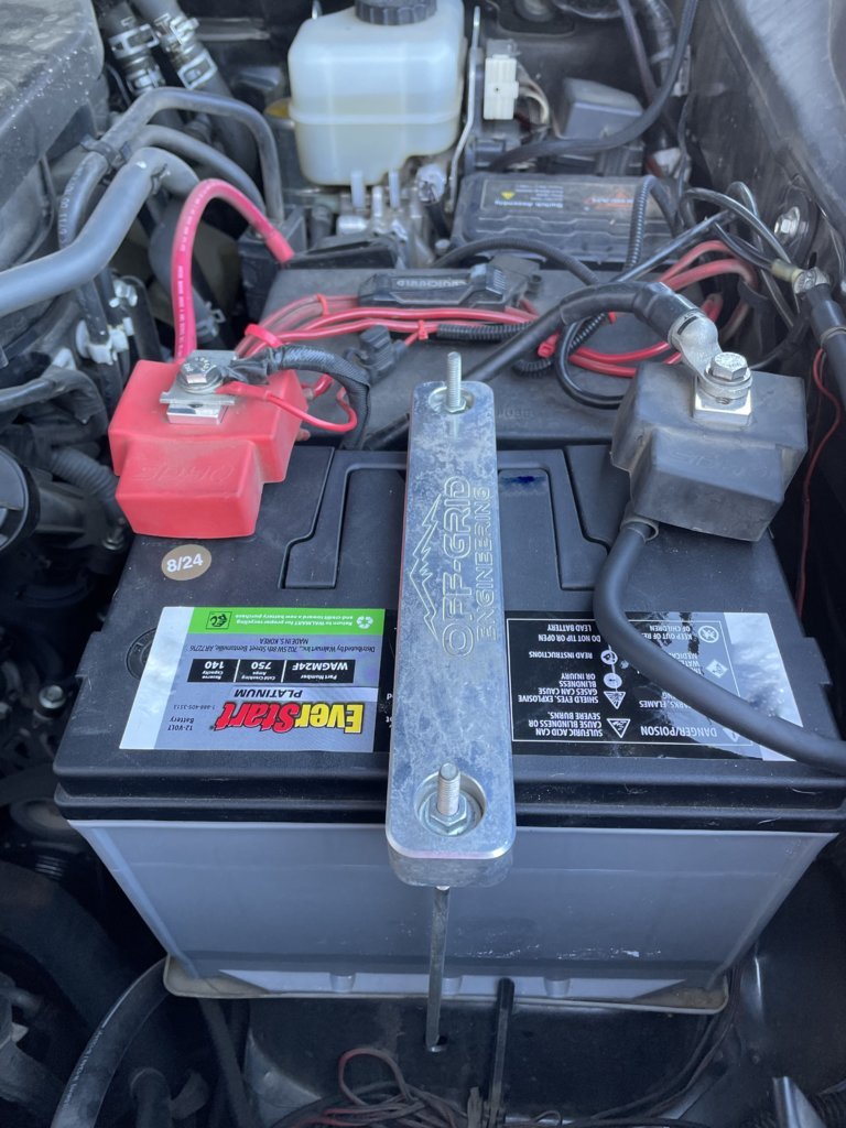

    I got a dual post AGM from Costco for like $190 OTD.
    24f not 27f though

    I’ve been eying that battery, but I have a 27f right now. Did you replace your 27 with the 24? If so does it still fit well despite the smaller size?
  19. Oct 28, 2024 at 5:39 PM
    #19
    WrecklessAbandon
    WrecklessAbandon They call me skippy
    Mar 25, 2019
    #287913
    4,812
    Travis
    Olympia, WA
    Crocs with socks
    My 3rd gen comes with 24f, there is a 27f available which I posted above. Might have to be special ordered, not sure.
    I suspect the smaller battery would fit though.

    IIRC the 27f they sell (that you linked above) is lead acid, not AGM. The only AGM they offer for tacomas is the 24f, hence why I was interested.
