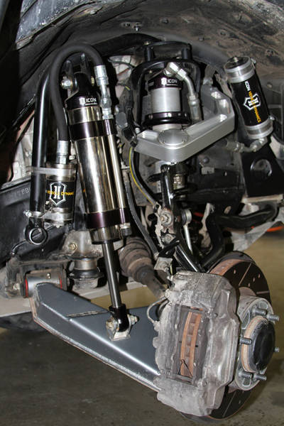

    are there any companies that make dual shock setups for the 09 tacoma?

    Not really. Its pointless. Unless your talking about a Coilover and Bypass.

    You can run a secondary shock using the TC LCA and upper hoop. Very expensive route but it is what it is... LCA is like 1600.00 and the upper hoop is around 350.00 :cool:

    Has or can this be done with the factory LCA?
    Edit: just went and looked at my truck... I'm thinking not LoL

    cant be done with stocks

    I'm still learning how to setup a good suspension setup... but in a typical dual setup wouldn't you want one to be the Coilovers and the second one something like a dual or triple bypass? So you can tune it?

    When you run a dual shock, you make your coil overs a coil carrier (basically take the valving out) and put all the valving into the triple or double bypass and tune hell out of that. Of course there are different schools of thought.
    I dont understand how you can get extra tuning out of running a coil over and a smooth body

    TC LCA: 1600
    TC dual 2.5 shock hoop: 375
    TC UCA: 650
    Racerunner 2.5F 2.0R Coilovers/shocks: 1700
    Racerunner 2.5 piggyback bypass shocks: 15-1800
    Deaver J66 leafs: 650
    This is just an example as I pulled some parts that came to mind.. yeah we can swap out arts here n there but this is just for quick reference... so totalling about 5600 for an above average MT setup?

    which equals just under $4000.
    You can get a new LT kit for around $3000 and find 2.5x8" coilover for $800.

    There seems to be a little misconception running dual shocks, I wouldn't call it a waste of time, anything that has wheels & uses springs for suspension whether front or rear, IFS or solid axle has to have dampening to compensate & soften heavier spring rates, dbl the shock value you dbl the dampening, now is it possible to dbl shock IFS ? Yes, Is it practical, I'd say no, but dbl shocking the rear wouldnt necessarily be a bad thing, I had 8 shocks on my '72 Power Wagon, it had 1 ton leafs & needed all the dampening i could give it...;)
