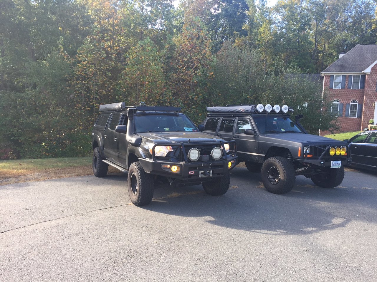

    Hey everyone - First post on this forum after recently picking up my 2013 taco. What I am wondering is if anyone has built a dual swing out tire for 2 spare tires. I see a lot of pre-runner style trucks with the dual spares cut into the bed or somehow installed in the bed. I've seen swing out bumpers for single tires, and dual swing out bumpers for a tire and jerry can. But nothing I see off the shelf that has a dual swing out for 2 tires.
    I called CBI and they are willing to build one for me but it is rather pricey. The main reason being I have to fork up some cash to have them cut out some new brake lights and turn signals as we are assuming having 2 spares will cover up the entire factory brake lights. I run 285s so they aren't huge but probably just enough to have issues with inspection or police, not to mention the safety factor.
    Has anyone on the forum seen this done on a taco before? I'm looking to see if this has been and what advice from the process. I know it is a fair amount of weight on the rear but having dual swing out arms will at least help with spreading the weight out across different hinges. It may require some suspension tuning after the install so I am aware of that. What other thoughts do people have out there? Btw, the reason for dual spares is because this is my overland build. My bed is completely stocked with fridge and overlanding accessories and space is always a commodity. Thanks!
    -Ben

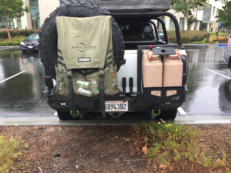

    I am not carrying two tires, but you can get an idea from my dual swing out. should work fine.
