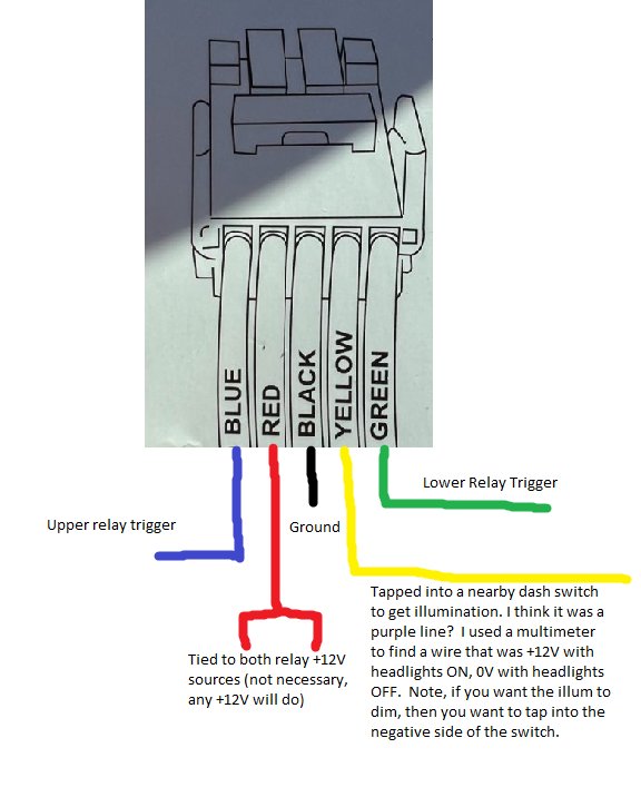

    Here's the way I read the wiring diagram:
    RED - +12V input to the switch (switched power or not) This becomes the output power when the switch is toggled.
    BLACK - Ground
    YELLOW - +12V will illuminate the switch. Our dash lights are wired differently, so this won't work directly wired. Yes, there is a way to wire this.
    BLUE, GREEN - output +12V when switch is toggled. Normally, run these to a relay to switch your device on and off.

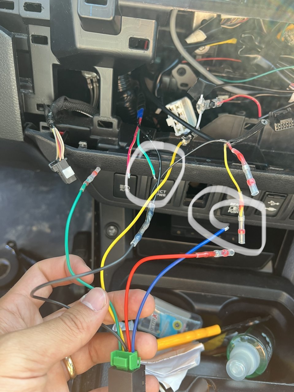

    Did you ever figure this out? I wired in my dual switch last night and ran into the same issue. All my single ch4x4 switches are wired to the same wires and work fine but not the dual switch.
    Pretty stupid now I can't use my two lights unless the truck is on.....or if I want to use them while the truck is off I have to have the switch lit up 24/7.

    Everything on my dual switch works as it should, minus being lit up 24/7 when connected to my 12v relay cable.
    Yellow wire is tapped to my tail light fuse so it illuminates when the lights are on
    Blue wire goes to my light bar relay
    Green wire goes to my ditch light relay
    Black goes to ground
    Red = this wire I tapped off a relay 12v source that my other two single switch lights use and DO NOT light up 24/7 but the dual switch does. If it was a constant 12v source, wouldn't my other switches be lit up 24/7 too?

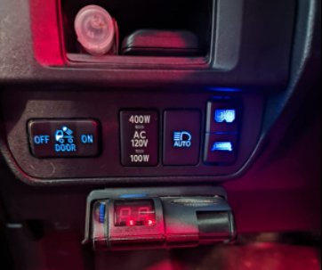

    I get what both of you guys are saying and I understand the difference between the red and yellow cable. That being said, even with my yellow cable not being hooked up, my switch was lighting up red (off) when hooked up to my 12v relay wire - which I guess would make it a constant source(?) BUT this is where I get confused....my other two single switches are also hooked up to this same relay 12v source. I have them all tied in together and they do not light up 24/7, only when my dash lights come on (due to my add a fuse) AND I can use them with the truck turned off...
    Again, when I hook up this dual switch to the same 12v source as my other single switches, it's lit up 24/7 while the single switches are not.
    So what is different about this dual switch or is it faulty?

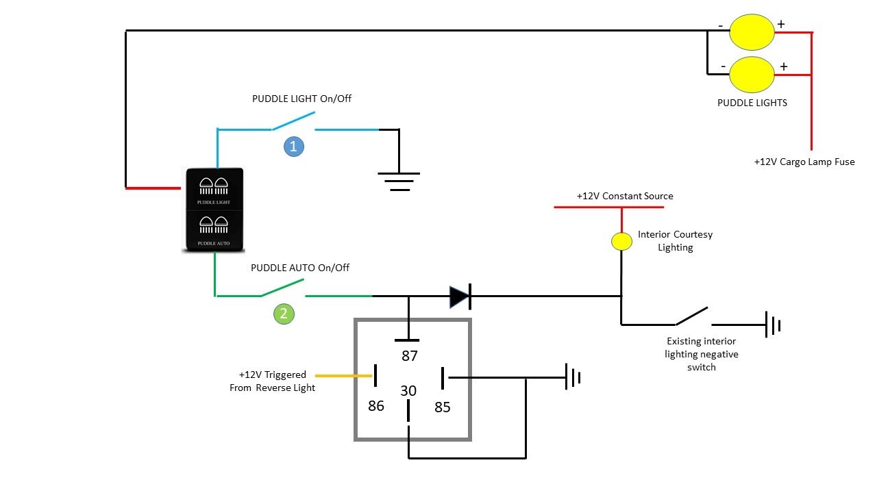

    I recently purchased one of these custom dual switches (April 2022) and have the same/similar issue(s) that started this thread.
    What I found is that the red and yellow pins are connected internally and they should not be.
    So, when I had 12V going to my red wire, since it’s [incorrectly] connected to the yellow wire pin, all my dash buttons were lit up when they weren’t supposed to be. In other words, 12V on my red wire was sending 12V through the switch, out the yellow wire and into my other dash switches, lighting them up.
    I installed a diode on the yellow wire to stop the flow from going to the rest of my dash buttons which stopped my other dash lights from erroneously lighting up. However my switch was still always lit up, whether the dash lights were on or not.
    I contacted Ch4x4 and told them what I found. They said their technician was out and just sent me another switch. As much as I appreciate them doing that, the second switch has the exact same problem, red and yellow wire pin on the switch are connected.
    I ended up leaving my yellow and black wires disconnected. I’m only using the red, green and blue wires which works but the switch isn’t lit up.
    I am running directly through the switch because the switch has a 3.0A rating and the lights I’m using only draw 0.3A.
    Setup is:
    -Top button/switch, when on, manually turns my puddle lights On.
    -Bottom button/switch, when on, the puddle lights turn On/Off same as interior cabin lights and also turn On when I select the Reverse gear for the transmission.
    Here’s my wiring:

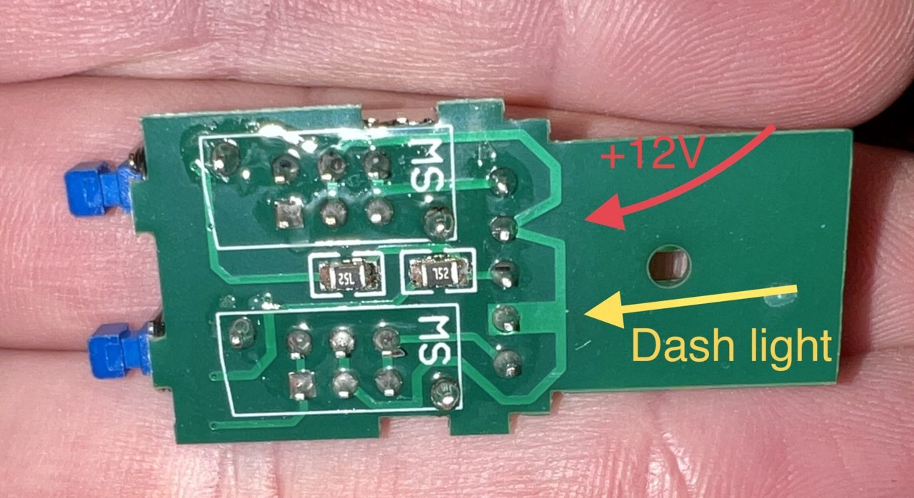

    I decided to open the extra switch and check things.
    On the circuit board itself the main red +12V wire pin and yellow dash light input pin are connected on the same path. Also, that yellow wire pin is only connected to that path.
    There’s no way the yellow dash light input wire can control turning the switch light on or off.
