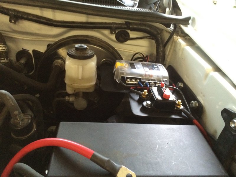

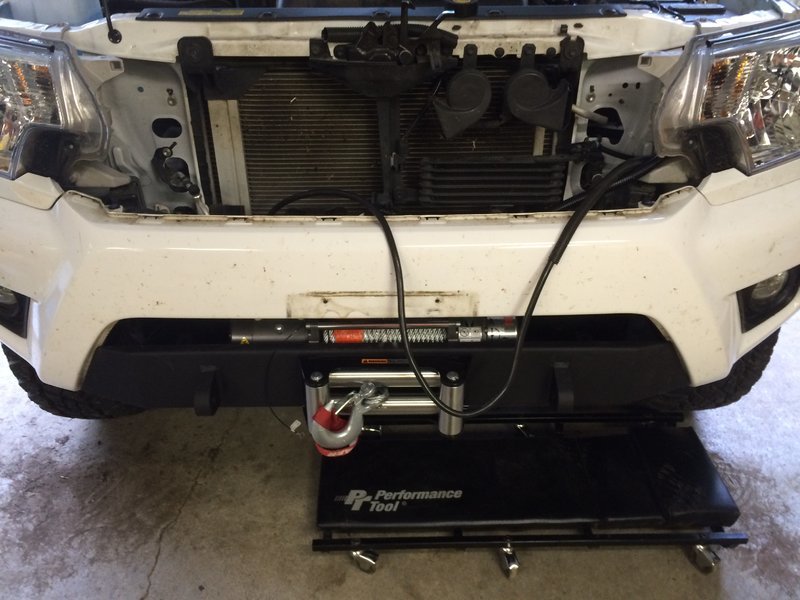

    Glad I could help. I'm finishing up a Us OR bumper with winch image.jpg and fuse block at the moment. This place is great for knowledge and ideas.

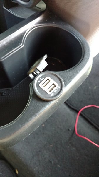

    Finally motivated to do add this for the kids charging. Finally no wires running from the dash. I ran a wire from my fuse block next to the battery and added a switch.

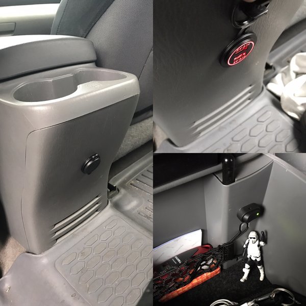

    I just did mine and got tired of cords running from the front! I went low like spaculley with my outlet.
    Thanks OP! Your instructions were spot on and got me going.

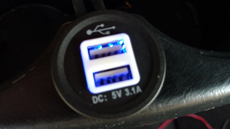

    I have done this exact mod 6 years ago and have had no issue. The lighted plug really does help at night.
