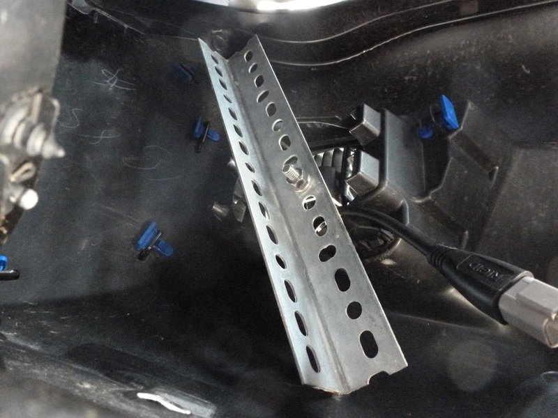

    It's not pretty, but it's simple and it works. Use the stock mounting bracket and rotate it to the back of the light. Slide it into the fog light hole and through bolt it to a bar or a piece of angle like I used (it was scrap). It fits snugly and does not rub on the wire. I don't remember exactly if the angle is pressing against the edges of the fog light housing or if the ends are pressing against the inside of the bumper skin, but you should figure it out once you get under there.
    So far I've had these in for a little over a year and have had no issues. The stock holes are too small to put the Dually inside, so it does stick out fairly far. I've got a 2012, but the fog light area should be the same for your 2014.

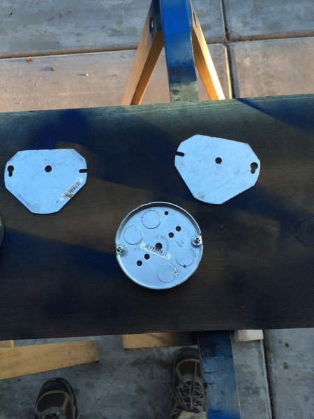

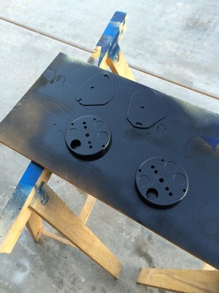

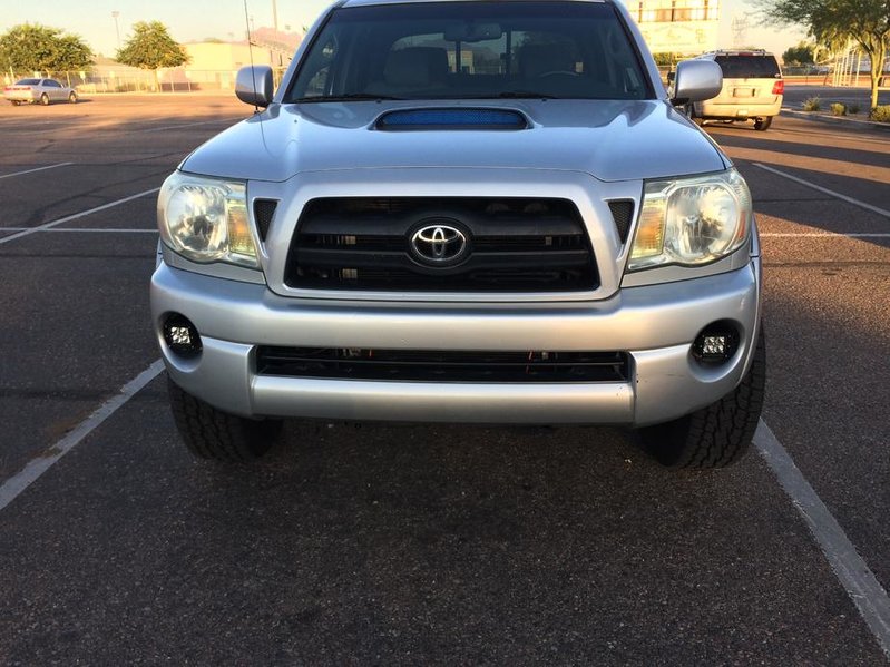

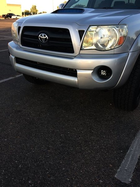

    I put Rigid lights in my 2007 with a little bit of modifcation it worked
